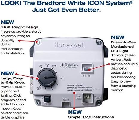

Later we contacted him again to get an idea of when he could do this and have a look at our home's setup. We figured he'd know enough about these to know what features were needed. I didn't get all those those little differences. He had a look at our setup to see what would be needed. He ordered a 40 gallon Bradford White Eco Defender water heater with a direct vent and a Honeywell V2 gas control unit. I haven't seen one quite like this before since there's no pilot door. It looks like everything is done through the gas control unit, including a built-in (manual) piezoelectric igniter like the ones in kitchen lighters or some of my camping stoves. At this point I have no idea how good this water heater is, but the plumber said that Bradford White is very good.

This has a status light that blinks green every few second if the pilot is lit. I guess if the pilot goes out it will eventually cool down and the status stops blinking. However, this is a lot more sophisticated than what I'm guessing was a purely mechanical setup of the heater that was replaced.
I found a photo of the gas control.
[Linked Image from images-na.ssl-images-amazon.com]

So that thing have batteries or needs power? Hopefully not another wallwart transformer....
I didn't see any connection to AC or DC power and there's no battery hatch. I was kind of wondering where the power was coming from to power the thing.
I looked it up. I found video showing a slightly different Honeywell gas control unit, and they say the power is generated by the thermocouple (a thermopile actually).
A Honeywell Q313 thermopile is supposed to generate 750 mV, which is enough to power the simple electronics. It sounds like the electronics are off until the pilot is lit and heating the thermopile. Apparently a thermopile is just multiple thermocouples in series, where a standard one will put out 30 mV. I guess it's more sensitive and able to put out enough voltage to power the control electronics. I real life I'm actually an electrical engineer, but I'm really a 1s and 0s kind of guy. This stuff is totally foreign to me, although I can sort of understand the language. I'm guessing I could probably figure out a data sheet for the control chip.
