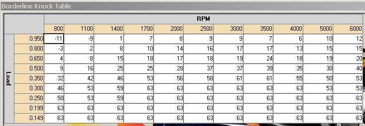

I found some old screen shots for the timing tables and KS advance and retard rate for my '97 Taurus SHO 3.4L V8.
This appears to be a WOT standing start run through 3rd gear, rpm on the left.
And here is the same run with spark on the left.
And here is the primary timing table.
Here i one from the turbo charged 2010 SHO. Not the diffrence in load values on the left due to boosted intake pressure.
The KS advance rate '97.
And KS retard rate, This appears to be rather restrained. I use to sometimes put large values in here so that when it knocked you would really notice. But it takes too long to recover.
This is a MBT timing table. Something Ford used to set the very base timing for peak torque.
