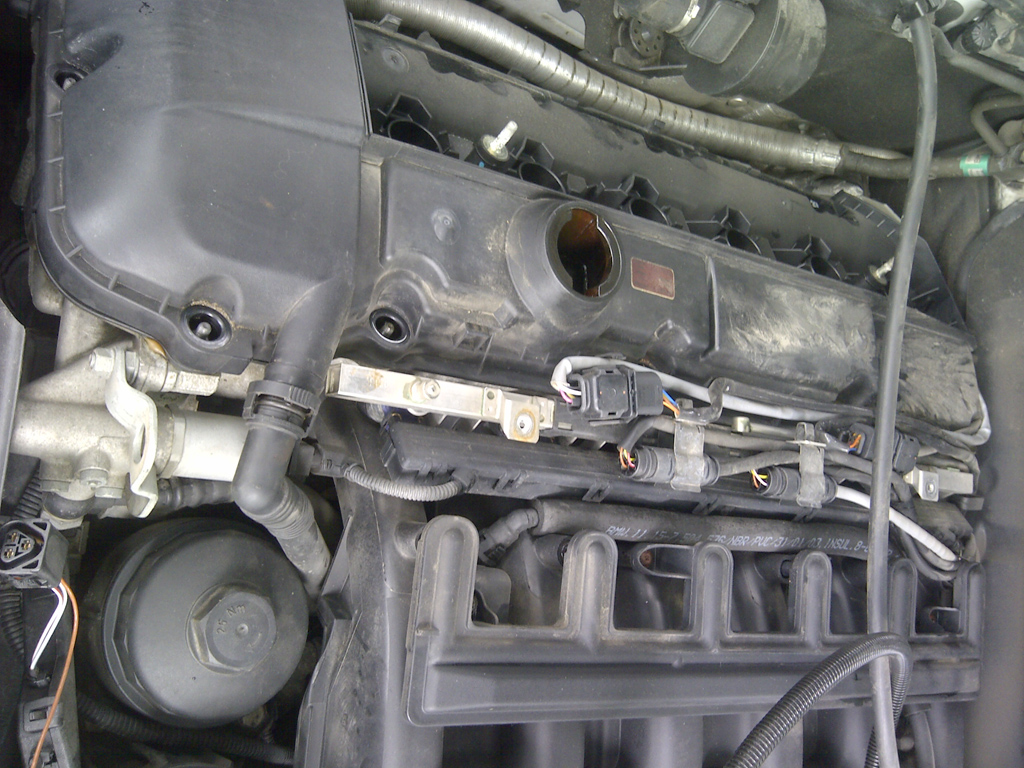

So my sister's valve cover gasket, like my wife's, was leaking.
She ordered the kit from BavAuto, and I changed it for her last weekend. Been working too much to post the pics until now.
We've been running Mobil 1 0w40 in it since she got it (less than a year ago), it only has ~138,000Km on it now. It looks like the Mobil 1 is cleaning up the varnish that the factory Castrol appears to love to leave behind. The varnish wipes off with a paper towel, so I wiped it off the VANOS area before putting it back together.
