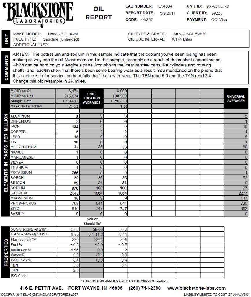

This oil was taken from my 2007 Honda Civic Si after 3,000 miles and put into a 96 Honda Accord 2.2L and used for an additional 3k.
Here's the first UOA from the Accord while using the recycled oil from the Si
Here's the previous UOA on Mobil 1 EP 5w30 after 6,000 miles total
~~CURRENT INFO~~
The Accord has developed a head gasket leak into cylinder #4 and that's how the coolant is getting into the combustion chamber.
Besides the extreme wear from the coolant contamination, i think the oil held up spectacularly well. Had it not been for the blown head gasket, this would have been another successful UOA from my oil recycling experiment... well, I still consider it a success in my book.

I forgot to mention that Blackstone Labs actually called me on the phone to report the Coolant found in the sample, causing excessive wear. I'm impressed! They do good work.
The point originally started with me wanting to see how much longer the oil could last after being abused by the modified engine in my 07 Si.

Problem is, I dont think the experiment is worth much this time because the results are so skewed by the coolant damaging the oil/engine.
Yes the results from the latest sample are skewed by the coolant breech BUT, like i've said in the original post, i'm not looking at ONLY the wear metals. I'm looking at the OVERALL condition of the oil after the extended run. Did it thicken, thin out some more, TBN and TAN count, etc etc.

If you look at the wear rates in the Accord's first UOA vs the average numbers, you'll see that there is less wear even considering the longer oil run.

I put a good bit of faith into the lab results. After seeing the UOA report @ 3,000 miles showing LOADS of TBN, i feel pretty confident dumping the dark, used oil into the Accord.
