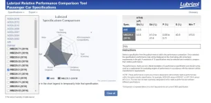

Maybe out of turn here - but the Mercedes-Benz 229.5 seems a more stringent standard to meet than the Porsche A40
- if we get down to specifics.
That tool is not designed to compare different certifications to each other, it even says so in the bottom, lol. To determine how it compares, you'd need to know the entire sequence of 229.5.
You're going to make me go read that! We're back to learning something new everyday.
Ah yes, see the Note's last sentence in the lower-right. That whole Lubrizol endeavor reminds me of interesting marketing in so many ways. :cool: :)
