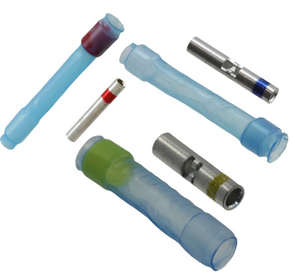

I use "raychem" environmental splices, and I solder them. They really are the only viable option when splicing trailer wires. I also use "de-oxit D5" when cleaning connectors with a bristle brush. It slowly, but nicely cleans contacts well. Then, during assembly, I spray with Corrosion X, Boeshield, or any other corrosion inhibiting oil. The thicker ones hold up longer.
Note: De-oxit D5 is not a conventional contact cleaner. It actually dissolves oxidation. So, copper contacts appear brand new after a bit of gentle cleaning. Conventional contact cleaners are simply degreasers and won't remove corrosion or oxidation.
