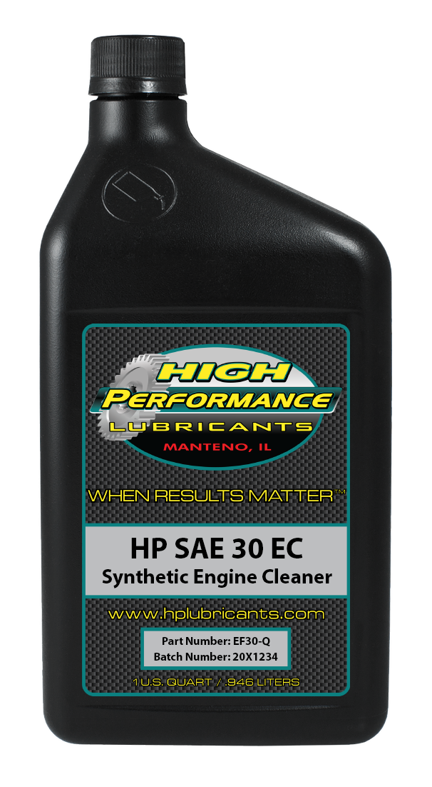

I'd try this:
https://www.advlubrication.com/collections/automotive-lubricants/products/engine-cleaner

Not worth it. Piston soaks and maybe HPL’s cleaner will yield dividends instead.

I definitely wouldn't use a flush but maybe an in-OCI, gradual cleaner like the HPL mentioned above, or Rislone towards the end of an OCI might be helpful...
