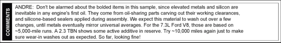

The Fast Lane finally did the first oil change on their 2020 "GODZILLA Super Tremor". Did I mention then went 9500 miles on that 1st change? They had Black Stone do an oil analysis on the oil and overall I agree it looked good, but I did notice it had sheered out of grade.
Considering their usage plans for this truck, the fact that it is lifted with oversized tires running a tune, I think 10k oil changes is way to much and that they need to be following the severe service schedule and changing the oil every 5-7.5k miles (preferably 5k).

First oil change on any vehicle has high levels of contamination and shearing. It has been shown on numerous UOAs here that the vehicle's UOA will settle down by 20,000 miles or so. So until they get to the third sample at 28,500 miles there is really nothing to compare.
I do agree with the early change philosophy, but suppose they were simply going by the OLM...which is not always accurate as has been discussed ad nauseum here.

One UOA, without a trend, doesn't tell you much about engine health unless there is something seriously out of line. Trended UOA's allow one to establish a benchmark and then watch for anomalies, but even then, deviation is a normal part of that. A significant departure from that trend or something showing up that shouldn't be there, like coolant, is when it shows value and warrants an investigation, but the odds of somebody trending UOA's on a consumer vehicle with sufficient frequency to catch something like a coolant leak without other obvious symptoms first are pretty low.
On the other hand, a UOA with TAN/TBN and ideally insolubles will tell you whether the lubricant is suitable for continued use or not, which can be extremely valuable. This is the target market, where a body is trying to extract maximum operating life out of a lubricant on large pieces of commercial equipment while staying within the safe operating envelope of the product. This maximizes ROI and will also catch contamination by virtue of regular sampling, ideally before it becomes severe and causes damage.
