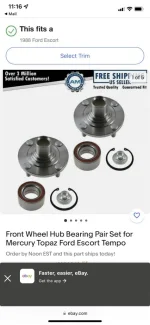

Do you have it apart already? That car uses a cartridge type bearing for the front, not individual tapered roller bearings which must be adjusted like on the rear.
The torque listed sounds correct for a FWD axle nut. The nut torque is clamping down on the inner bearing race only. The bearing is preset internally like someone else said.
he’s talking about the real ford escort
https://www.ebay.co.uk/itm/14280483...ToYZnLmLgYlOf2CvOd9OSuU/bK|tkp:Bk9SR8ab6uXhYA
Ah, ok. I’m guessing the bearing races are made so that when assembled, endplay will be correct.
As said above, probably safest to ask the dealer.
I guess i'll give it a try but i am afraid my local dealer is completely clueless about anything pre-2000, i only go there anymore to get spark plugs and oil filters, which is pretty much all they sell anymore for an Escort lol
But yes i've already installed the new races and bearings, seals and everything, it's pretty much ready to go now, just trying to figure out how and how much to tighten them.
