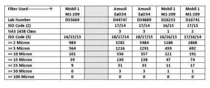

I tend to disagree look at the particle count form this M1 VS Amsoil Filter Study:
The only reason why an Amsoil oil filter would not clean as well as a M1 again and again is if the bypass valve is open due to the filter being clogged.
Here is the link:
https://bobistheoilguy.com/forums/threads/a-comparison-of-mobil-1-and-amsoil-eao-oil-filters.94852/

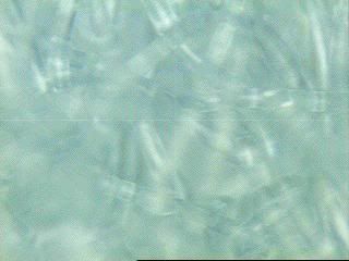

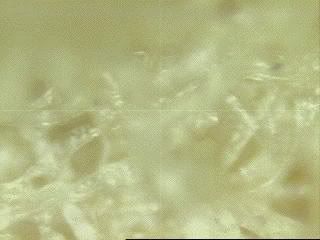

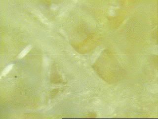

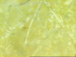

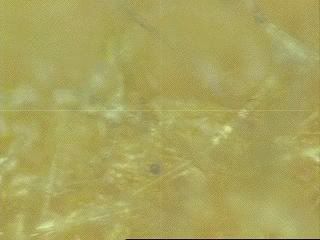

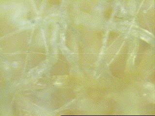

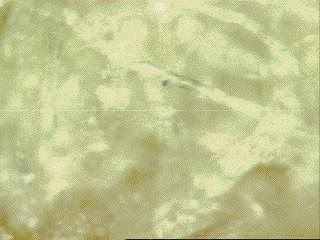

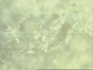

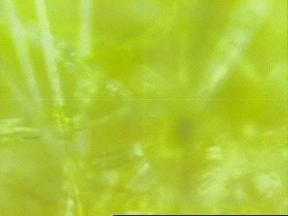

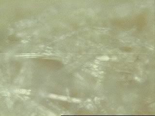

Here are some images of the media:
Amsoil:
M1
OEM Hyundai
SynLube/ACDelco
Bosch
Fram Extended Guard

Sorry, but transferring the data form the microscope to the computer to the editor and then to photo bucket resulted in substantial loss of clarity.
The depth of the element material has to be included in the elements holding ability. A filter element is more than a screen.
