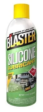

My Tercel has always been terrible about everything freezing shut. If it was cold enough to have frost on the glass I was gonna have problems. When we started getting cold here I sprayed this on a red shop towel and wiped all the seals down with it. Haven’t had a problem all winter. My weatherstripping is in bad shape already so I can’t say anything for preserving it.
