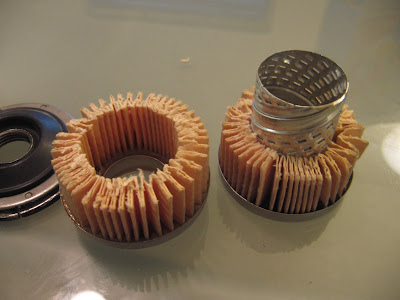

Hi folks,
I was at my local Wal-Mart and figured I'd pick up some SuperTech fiters. While I only needed one for an upcoming oil change, I bought a second for science.
Here it is:
As you can see, it has a black, very flexible ADBV and the blue-button bypass valve. The ADBV has a little ridge around the center that fits tightly against the end caps (this was not visible in close-up photos, so I didn't bother posting it).
This particular model is not an ecore, and has metal end caps on the paper filter media. The central tube is metal.
The paper has a pleat depth of ~1cm. The ends are glued rather heavily into the end caps. Pull as I might, I am unable to tear the paper out of the end cap, though I did end up cutting myself on the end cap (hooray). I ended up cutting the paper with a knife to see that it was also heavily glued on the inside of the ends as well.
All in all, it looks like a pretty standard Champion Labs filter, and I noticed no part of it that seemed low quality, cheap, or flimsy. Not bad for $2.57.
Much the same as the STP 3950 I cut open and the one I sent river Rat to test. It was highly similar to the Classic L10193. I think the ST has long been a decent filter and as good or better than ones costing more.
For those not infatuated with steel end caps, I think the Ecore is an upgrade.
Oh, I was in my AZ last week and they had STP 3950's right on the shelf.

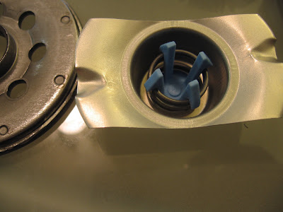

Thanks for the pics. I have the same filter waiting for my next OC. Can you explain how the blue-button bypass valve works on this filter. I can't really tell from the pictures. I'm guessing there is a spring underneath preventing the blue button from opening.

Exactly. In the picture, the filter media and the bypass valve are upside down (for clarity). When normally assembled, the filter media has the little collar at the top fitted into the ADVB. The bypass valve is then blue-button-down and fits into an opening at the end of the filter media opposite the ADBV. The button holder (although it looks like one, it's not a leaf spring) bit holds the bypass valve assembly away from the inside of the dome, so as to allow oil to flow through the button if needed.
Inside the assembly, there's a coil spring which pulls up (towards the dome) on the button. When bypassing, the button is pushed down by oil pressure about 1/4" into the hole at the end of the filter media, allowing oil to flow through.

It does open. I don't have a scale to measure it, but I could open it with firm pressure applied by my thumb. It appeared to open and shut consistently, and after several open-shut cycles it seated back in the same spot without any visible variation. There's no o-ring or other seal between the button and the holder assembly, or the holder assembly and the filter media end cap, but they fit snugly together.
I took a few more pictures to explain how things fit together in case my written explanation was inadequate:
Additionally, I cut apart the filter media and took a few pictures of the inside:
Note the liberal use of glue to hold the filter paper onto the metal end cap:
Here's another close-up of the back end of the bypass valve:
