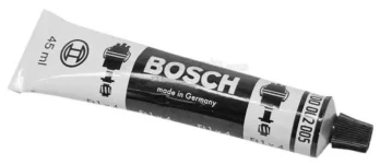

I always heard the Bosch stuff that was about $50/tube was the gold standard, but as best as I can tell it's been discontinued.
