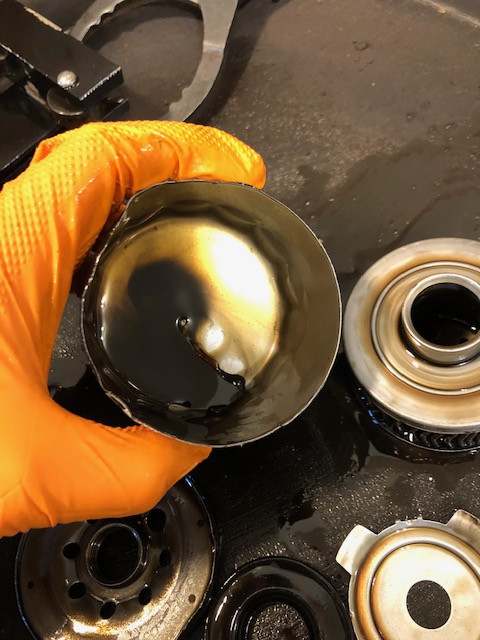

Stens 120-523 cut open
Apr 15, 2010
7,608
Connecticut

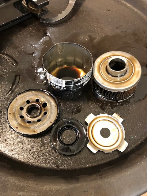

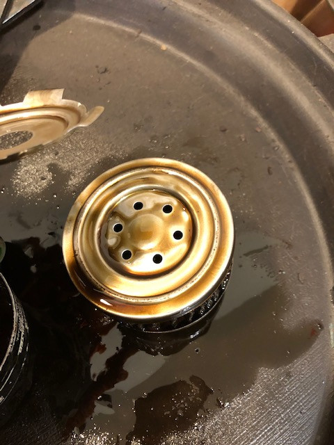

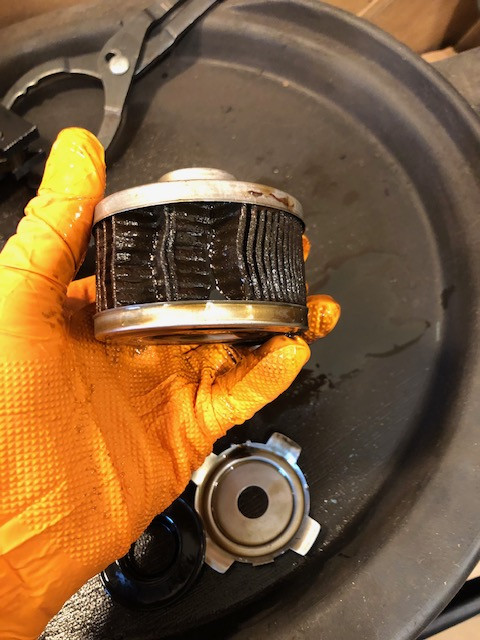

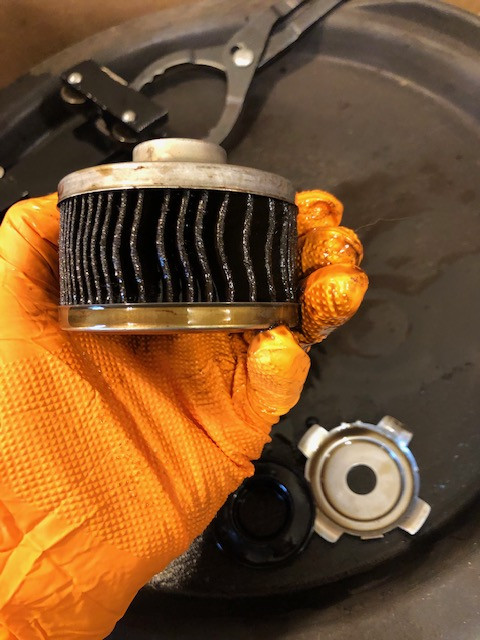

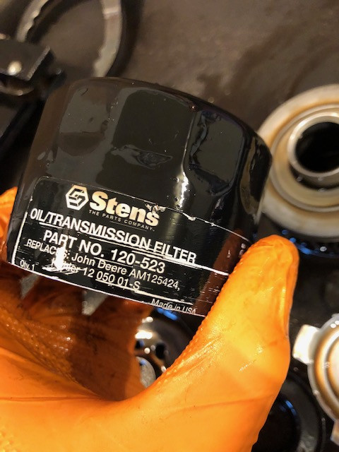

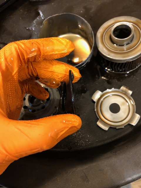

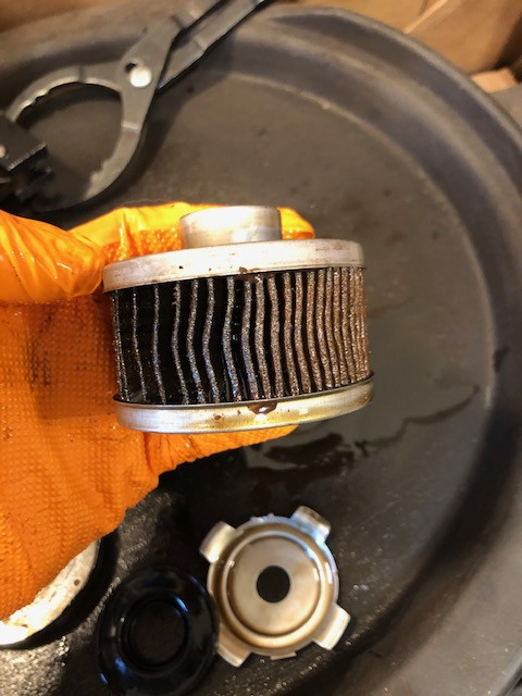

This came off of a customer's Toro Timecutter zero-turn with the 24hp Kohler Courage V-Twin. It was in use for at least 2-3 years. These filters list on Amazon for close to $10, and are likely more at local small engine dealers. They are the aftermarket replacement for Kohler, John Deere, Briggs and Stratton, and many other small engine OEM filters. I wasn't that impressed with the filter media, and the bypass seems to consist of holes in the back of the media cartridge that rest against the leaf spring. The ADBV was hard as a rock and likely wasn't doing much. The oil out of this mower was jet black. It left with a Wix 51348 filter and some Napa Synthetic 10w30. thumbsup [Linked Image from i.postimg.cc] [Linked Image from i.postimg.cc] [Linked Image from i.postimg.cc] [Linked Image from i.postimg.cc] [Linked Image from i.postimg.cc] [Linked Image from i.postimg.cc] [Linked Image from i.postimg.cc] [Linked Image from i.postimg.cc] [Linked Image from i.postimg.cc] [Linked Image from i.postimg.cc] [Linked Image from i.postimg.cc]

Thanks for that cut and post. I have used a couple of Stens products in the past and it seems that their products are a cut below oem.

The can seemed decently strong, but that was the only good point I saw. Just like the OEM small engine filters, they just seem to be way over priced for what you get. The Wix that went on is a much better filter and I got it for $5.50 or so on Amazon. For the last 10 years or so, I have not used any OEM oil filters unless provided or requested by customers. The exception to that would be the Kawasaki or Honda OEM filters, as sometimes they can be found pretty cheap on ebay and are decent quality for their small engine applications.

Super pleat spread ... eek
Why some manufacturers have a small gap and others have a big gap ?
Wide pleat gaps = sloppy manufacturing.
Mar 20, 2016
3,445
Western S.C.
Originally Posted by Kira
....and less material used.
Sometimes so, if spacings are wide due to a low number of pleats. Other times when the number is higher, a few super-wide pleats just mean the others are crammed tightly together, which isn't good either.

Yup, on this one you can see the pleats are pretty close together on the other side.

Definitely. I've opened Kohler, Briggs and John Deere OEM filters and they aren't anything special, probably closer to the cheapest SuperTech filter you can buy. A Wix or Fram Ultra would last several years with no issue, heck this filter was on at least 2-3 years after talking to the owner, maybe more, and it held up okay besides the ADBV being stiff. The only thing I would caution you on is using filters that are much larger than stock. Some of these small engines fill up the oil filter first before sending oil to other areas, and with their low amount of flow to begin with, a faulty ADBV on something like a PH3600 might take a bit to fill up before sending oil to other areas. The smaller filters (like a Wix 57035 or Fram PH8170) actually have pretty robust cans and still plenty of filter media for an engine that small.
