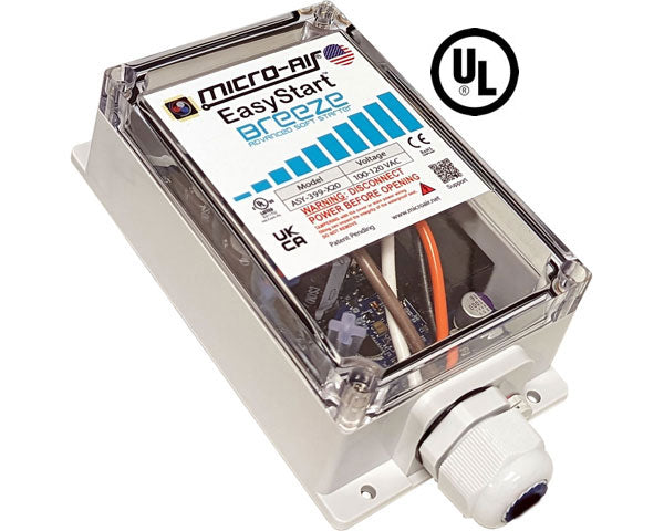

Anyone have experience with a soft-start unit with their residential A/C unit? Looking for feedback.
Like the one pictured below:
All I've seen are positive reviews. I would enjoy the quieter starts and ability to run the A/C with my backup generator.
No experience with residential but installed one in the travel trailer and it works as advertised. I can start and run the AC with a 2500W generator. Came with good installation hardware and USA made. Not cheap but worth it.

I installed one on my home 4 ton unit 3 years ago. It lowered the inrush current by about 60%. Don't know about extending the life of an AC but it makes the start up much smoother. It lowered the inrush current by about 60% on my home 4 ton AC unit.
Easy to install if you can follow the directions. Depending on your AC brand you might have to consult MicroAir for some specific instructions.

Never seen one like your photo. I use Kickstart or Supco.
