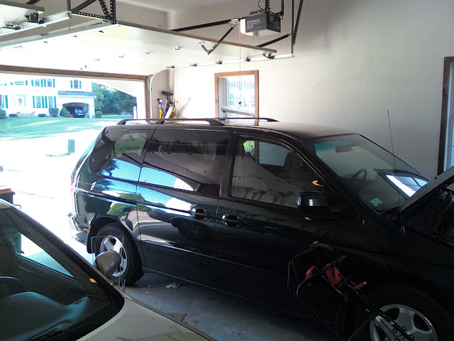

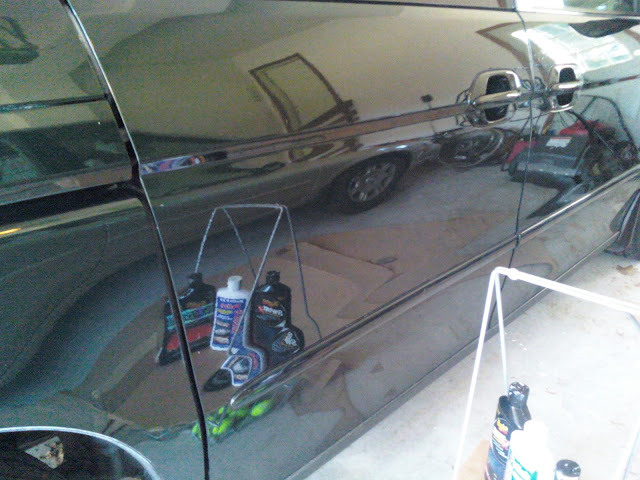

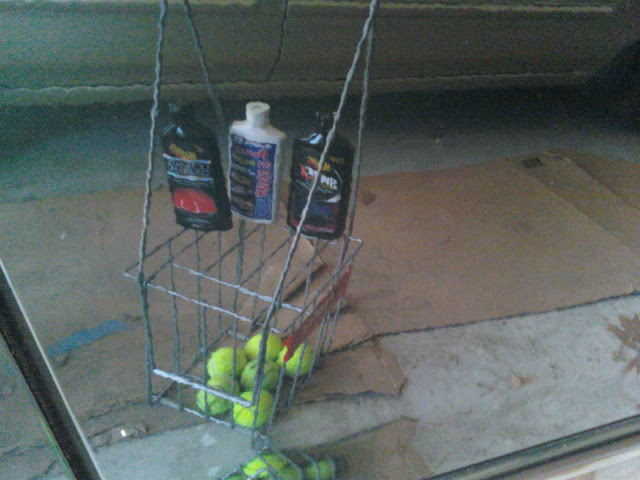

Chemicals shown in the pictures. You just have to be able to read the reflection shots (Walmart, Advance Auto, Carquest)

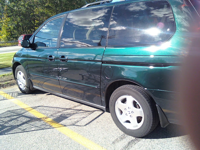

You be the judge

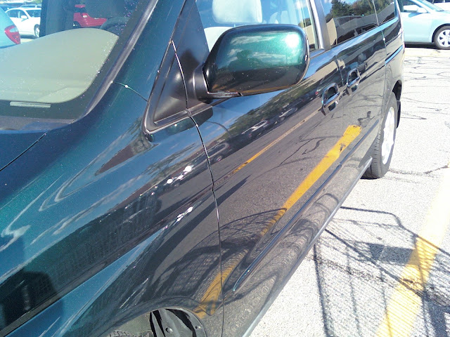

Those pictures were taken at the super market and I was indeed loading grocery at that time :-) You can even see reflection of grocery cart!
Amazing thing is that there had been many years when this van was not even washed and it lives in NorthEast. If you look closely in person, you would see galore of my attempts at scratch fixing using wet sanding methods. Some of them came out great, some not so. It is pretty much impossible to match the metallic touch up paint when viewed from all directions but I can now do a good 3-feet job with the body shop left over paint. With the dealer OEM paint stick, it color shifts when you wet sand it. Body shop paint is dull when you apply but buffs out nicely and color matches very well. There are some scratches which I can't even find them anymore at 1 feet distance.
