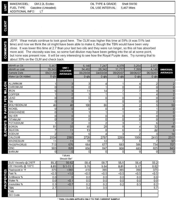

Most recent UOA for my Chevy HHR...had some Shell 5W30 SM flavor left over from buying as bunch at Walmart on the cheap. Doesn't seem too too bad although it did shear a bit. Filter was OEM AC Delco. I think I changed the air filter out about 1000 miles into this run
New fill as mentioned in report is .99 cent Royal Purple I picked up on closeout at AutoZone.

Good results here - this oil is a real bargain for the performnace you get out of it - you could have gone almost 7k miles on this run, I'd bet....

Got the same good results with Formula Shell 10w30 in my 93 Mazda 2600i pickup with a 5K OCI. Sheared as well but the wear numbers didn't show it. Formula Shell is a real bargain.
I doubt the viscosity reduction is due to fuel as there is no fuel to be found nor any extra wear.
Do the 2.2L Ecotech's have timing chains or belts? If a chain, seems to me the oil sheared back somewhat since it got beat up by a timing chain.
