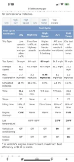

From what I can find, the only difference for manuals is the shift points, otherwise they follow the same tests as everything else.
https://fueleconomy.gov/feg/fe_test_schedules.shtml
The EPA test's shift points for manuals are abnormally high (at least for how I drive); accordingly folks most often better the EPA numbers with manuals. Automatics... not as much.
