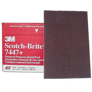

scotch-brite is fine, I've used the 3M discs a billion times to clean off gasket surfaces and clean decks. What you don't want to use is something like an SOS pad or something extremely abrasive that is going to damage the surface.
I assume you used something that looked like this?
If so, you'll be fine, just make sure you CLEAN THE AREA THOROUGHLY. I use a shop vac and then alcohol or mineral spirits on a rag until everything is spotless.
That being said, you should ALWAYS cover all holes/orifices as you don't want the particulate you are removing from the surface getting into the engine. Did you just go to town with nothing covered up?
wipe cylinder down real good. First vacuum cylinders. Take drain plug out of oil pan and spray cam area real good like 5 cans of carb cleaner . Pour some cheap motor oil over cam and lifter area real good. hopefully it will flush out the drain plug. Thats my best advice I can think of. Just flush flush flush.
That's exactly what I used, however I pulled up the MSDS and it states that it has aluminum oxide in it.
What I am interested in knowing how "dangerous" these particles are. If I change my oil after I run the engine for the first time. Then change it after 100 miles, will that remove most of any particles of concern OR do metal particles tend to embed themselves.

They are as dangerous as any other abrasive material getting in the engine, that's why you cover things up so that you isolate where the material removed and anything shed from the removal tool can go.
I'd flush the [censored] out of it if you've managed to get it into the engine at all. If you feel you got it on ANY bearing surfaces, disassemble and clean it out, there's no other way around it.
You didn't go wrong using the abrasive disc or pad. You went wrong not covering things up/plugging holes.

These are the 3M discs (and holder):
Ok...............................?
Used by mechanics and engine builders to remove gasket material. The pads for this tool are no different in composition than the hand pad you used. These are scotch-brite rotary pads and tool.
