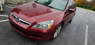

I just recently had the front end of my '06 Accord apart to put on a replacement fender, respray the bumper and some other parts.
I also sanded and cleared the headlights. I noticed on the top of each headlight housing, in a place you could never see or touch when in the car, there was a single small black rubber plug. A vent I'm assuming?
After I finished with them I pulled one of the plugs out in curiosity. They had clearcoat on them now. I put it back in but I don't recall which headlight since they were out of the car.
Within a couple days of putting the car back together I had moisture in the driver headlight. The moisture has been getting worse.
I'm not sure if it's the one I pulled the plug out of or not. But let me tell you what a pita it will be to remove one headlight. The front bumper will have to come off, I managed to put the car back together without scratching any of my fresh paint.
Can I drill a small hole somewhere else in the headlight housing and somehow recreate what it naturally had functioning before? For all I know the plug I bothered with is the one with moisture.
Kind of funny to me, since I just did paintwork on the car my friends/family are interested in looking at it and now it's got this screwed up headlight so that's the focal point.

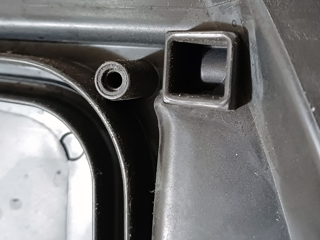

Vents on the OE Mini halogen housings.
Air inlet at the bottom of the housing. The vent is located in the square recess.
There is one air outlet on each side of the housing near the top facing the firewall. The vent terminates in a short length of rubber tubing.
