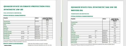

guys forgive me for not understanding the technical lingo of the data sheets, but based on these specs, which one is the better oil? to me they seem fairly equal. are they? i tried searching google for what the terms mean but i cant make sense of it much. any help is appreciated though.

Ultimate doesn't carry the dexos rating
Yeah it does man. QS Ultimate does carry the Dexos gen 3 approval on the containers.
To the original poster… Either oil is a very, very good oil to use. Just go by your vehicle manual for appropriate winter rating and operating viscosity needed and how long that change interval should be for your particular engine.
You won’t be able to tell much difference between spec sheets or VOA/UOAs, but the manufacturers specs they meet and suggested use life are good indicators from the blender. Since Ultimate is rated for up to 20k by QS I would call that a clue.
Tone original poster… Either oil is a very, very good oil to use. Just go by your vehicle manual for appropriate winter rating and operating viscosity needed and how long that change interval should be for your particular engine.
I didn’t catch that I would have thought it should. Thank you

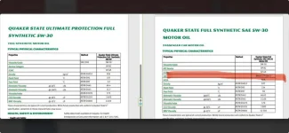

One slight clue is QS Full’s slightly lower pour point (& slightly lower visc. index)-that COULD indicate a slightly better base oil composition(?) Otherwise-yeah, the cheaper one!
All other things being equal, a "20K" or "extended protection" version of a product is usually a "better" formula than its "non-extended-life" ... but that depends on whether BITOG can agree on what constitutes "better" as it depends on application...
The Dexos 1 Gen3 + "20K miles" claims on the ultimate bottle mean that the oil is likely starting off with a higher TBN and better consideration for modern engine concerns like LSPI and aftertreatment compatibility. I would expect that to be the better oil. With that said, it's always possible they put the real magic in the other bottle and just decided not to take credit for it....
mdocod's opinion sounds about right. Two VOAs side-by-side will likely show us a difference in add-pack numbers.
Base Stock differences?...... I dunno. I sspect some Natural Gas base, mainly because the Ultimate in 5w30 is thinner viscosity than the default, vanilla QS Synthetic.
That's the norm with Natural Gas and SOPUS........ gets thinner - shears a little less and lasts longer.
