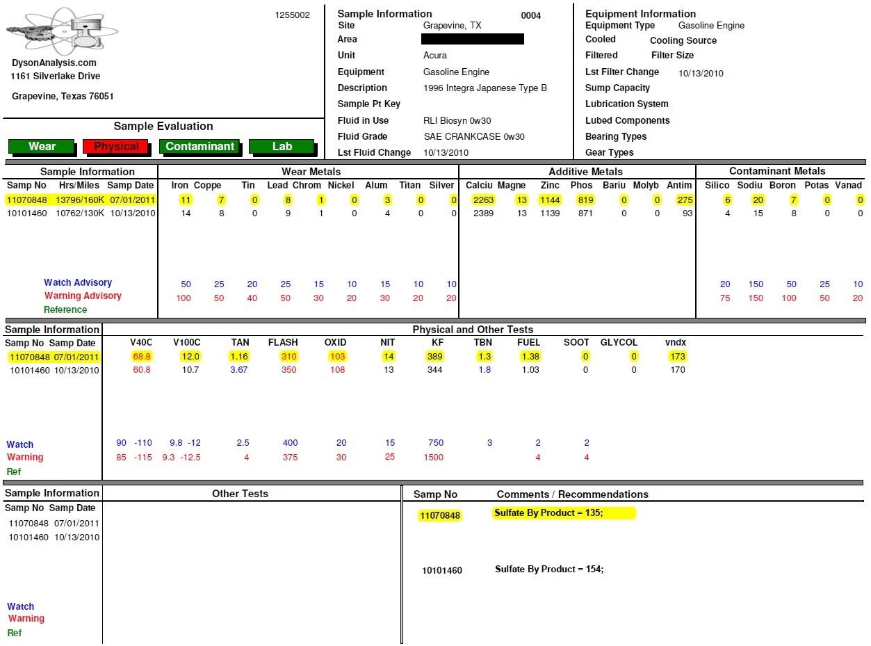

RLI BioSyn 0w-30, 13796 mi, 1997 Integra Type-R

Yes, that's almost 14k miles -- on a 100 hp/L high-RPM engine with a 4-quart sump, and engine oil that definitely was NOT designed for long drains.
Previous thread with details on the car: https://bobistheoilguy.com/forums/ubbthreads.php?ubb=showflat&Main=141601
The previous UOA was on the old version of the formula. This UOA is on the updated version, which has much more antimony and much more shear-stable VIIs. On top of that, the chemistry has settled in a bit, which further improved things.
On the flip side, fuel dilution and nitration increased, the car saw more hard use (i.e. WOT all the way up to 8600 RPM), and obviously the OCI was significantly longer.
Results: Oil consumption has dropped (now 1 qt/2600+ miles and still falling), shear has vanished, all wear indicators are the same or better, and -- this is what gets me -- it looks like we could have squeezed a few more miles out of this run without too much worry.
It's almost unreal. This relatively lightly additized oil is producing stellar reports and running incredible OCIs in this engine. We are getting the benefits of an "energy conserving" oil without the drawbacks -- not to mention incredible cold-start performance without poor high-temp performance or shear stability. Needless to say, we are sticking with it for the next OCI.
If we could just fix the tune, I bet we could squeeze 20k out of this combo...
Less than 1 ppm iron per thousand miles is really good. All the other values are pretty stellar too. I'm not sure I'd run it much longer, however. The TBN is getting fairly low.

With a TBN of 1.3, I could see going 15k, but probably not 20k.
Also, I'd say you are at the end of this run, b/c the oil has thickened up somewhat to 12cst - virgin is around 11. NOT that this is a big jump, but it is showing that thickening is just starting.
Impressive run.
If the tune improves, TBN probably won't deplete as quickly. The next run might improve things as well as the chemistry settles in further. We would only attempt 20k if all of that panned out.
I think so, too. The vis @ 40º is slightly thicker than the virgin spec as well.
The oil will be changed shortly.
