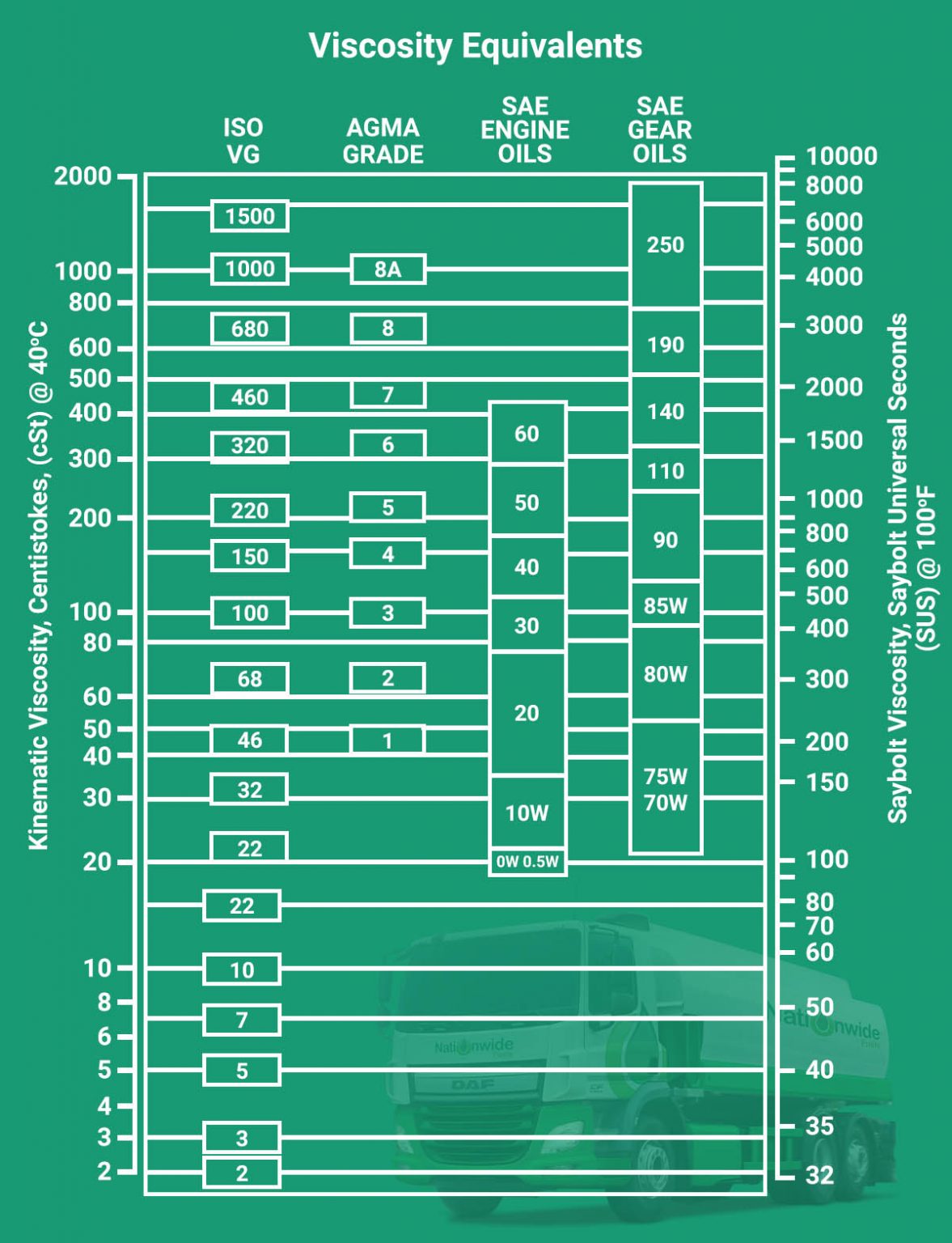

Just for a frame of reference here's a chart that shows the relative viscosities of gear, motor and hydraulic oil. I've included a link to the original web page so you can see it at it's source.
https://www.nationwidefuels.co.uk/oil-guides/hydraulic-oil-facts-information/
