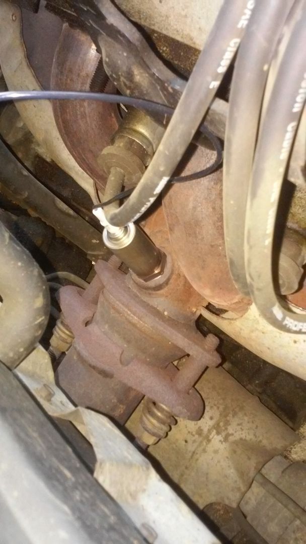

Another post about the 1991 Buick Park Avenue. It was in the shop the other day for the stalling issue when warm. All I know is that they replaced "a couple sensors". A family member took it in and we don't have the work order to reference. We were peaking around the engine bay today after checking the coolant and noticed what looks to be a new sensor. I assuming this is one of the O2 sensors? Just wanting to confirm! Here is a pic....
Ok thanks for confirming! Could this sensor in this particular location affect MPG?

Absolutely. Probably more than any other sensor in the car.
Probably no sensor after the cat for a '91 which is pre-OBD-2. So there is probably just a single sensor on this vintage car.
But yes, that's the new O2 sensor.

Can't remember exactly, but I think if that sensor is bad it could put it in limp mode, which runs on the rich side, and causes the engine to consume more fuel. Might be a good idea to do an oil change if it has been running rich a long time, at least that's what I would do, but I am OCD!
Upstream O2 sensor is directly responsible for controlling Air/Fuel ratio. A bad sensor will cause lean running (hot, pinging, and bogging) or rich (black smoke, high fuel consumption, and poor running.
I could be seeing wrong because of the camera angle, but it looks like the O2 sensor wire is lying on the exhaust manifold.

It is a 91, with only a single sensor. No upstream vs downstream and no bank1 vs bank2. It's a single wire non-heated sensor.
People keep treating this as if it was an OBD2 car. It's not. It's pre-1996, so it's not OBD2.
