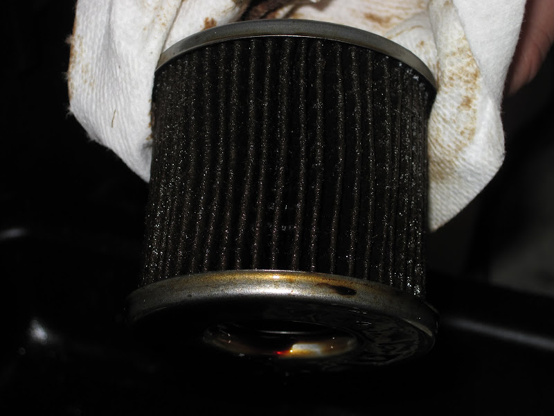

Quaker State QS4386, 8k miles, 7 months, cut open
Aug 12, 2010
429
Iowa
A Quaker State QS4386 ($2 from Menards) taken off of a 2005 Suzuki Aerio. Running Quaker State Ultimate Durability 5w30. The 8300 mile OCI was not planned, it was not my car and lost track of the mileage. As said in the subject, filter was on for 7 months. Everything looks good as far as I could tell. The one negative was that the ADBV was stiff (to be expected). The filter still held oil, but I wouldn't push the cheap ADBV much farther.
The Quaker's I've cut open have been Purolator made. But the bypass valve and baseplate holes don't match the one's I've opened?
Wonder who makes this one?

The OP's is Purolator made too. The smaller Puro made filters use the 45 adaptor looking bypass, and circular adbv holes. The larger use a coil spring plunger type bypass and sometimes oblong looking holes.
For $2, nothing at all to complain about. Looks good.

Looks the same as any Purolator Classic that I've seen. The ADBV should be hard since it is made of Nitrile rather than the silicon, which is found on the Purolator Pure 1. I like these Purolator Classic clones since they give great oil flow and good filtration. IMO...These Oil Filters are the Best bang for the buck on the market. I prefer these to the P1.
Looks very good for a 8K, 7 month run with no problems.
