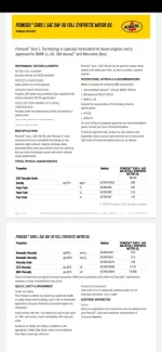

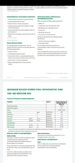

My guess is it is 12.5cst like Pennzoil Platinum Euro L 5w30 as they are likely the same oil just different bottles. Quaker State Full Synthetic Euro 5w40 is 13.3cst so probably is just a mistake in the print for the 5w30. Could be wrong but just a thought
