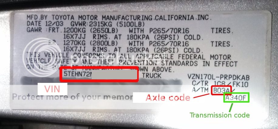

The vehicle tire placard has been mandated to be on the driver's door or driver's doorpost only since 2008. The format was also changed at the same time to make it more visible.
Prior to that there wasn't a standard format, nor a standard location. Many car manufacturers put in in the driver's door area, but they also put it in other doors, in the glove box, on the fuel filler door and in the trunk. And it sometimes was part of a number of semi-related things, so it didn't stand out. The photo above is a good example of how someone could miss it.
