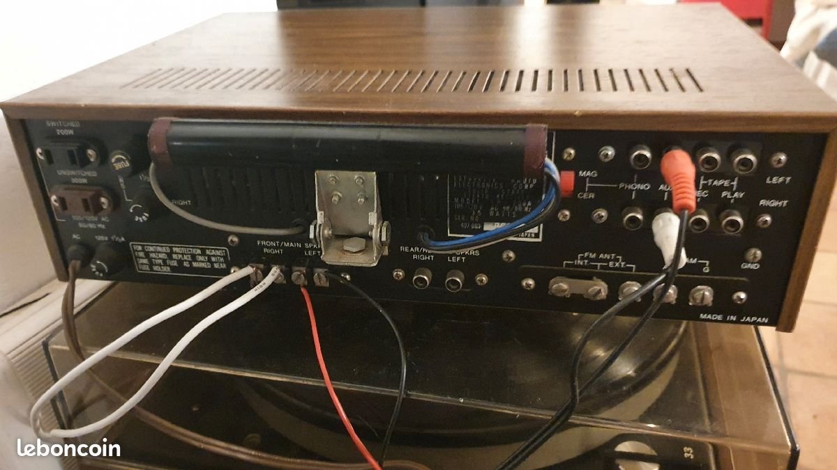

I have 1973 lafayette receiver with small flat head screws for the speaker outputs. Have always just tried to wrap the bare wire around the screw and tighten. I have new speaker wire coming (current is old and was questionable due to age and initial quality) and was wondering if there was a more proper way with a fork connector or such made for this purpose. It's pretty tight space wise, so I don't think any of the automotive type crimps will fit.
Just wrap and carry on or is there something better here?
