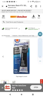

I think I'd go with some RTV sealant like Chris142 suggested, clean the area around the hole, fill the hole then around the hole on the outer surface, and scrounge up a scrap of plastic to bond to the outer surface. However the sealant you put into the hole, may take a very long time to set up, days without using the A/C, while an epoxy can set in minutes to hours.
