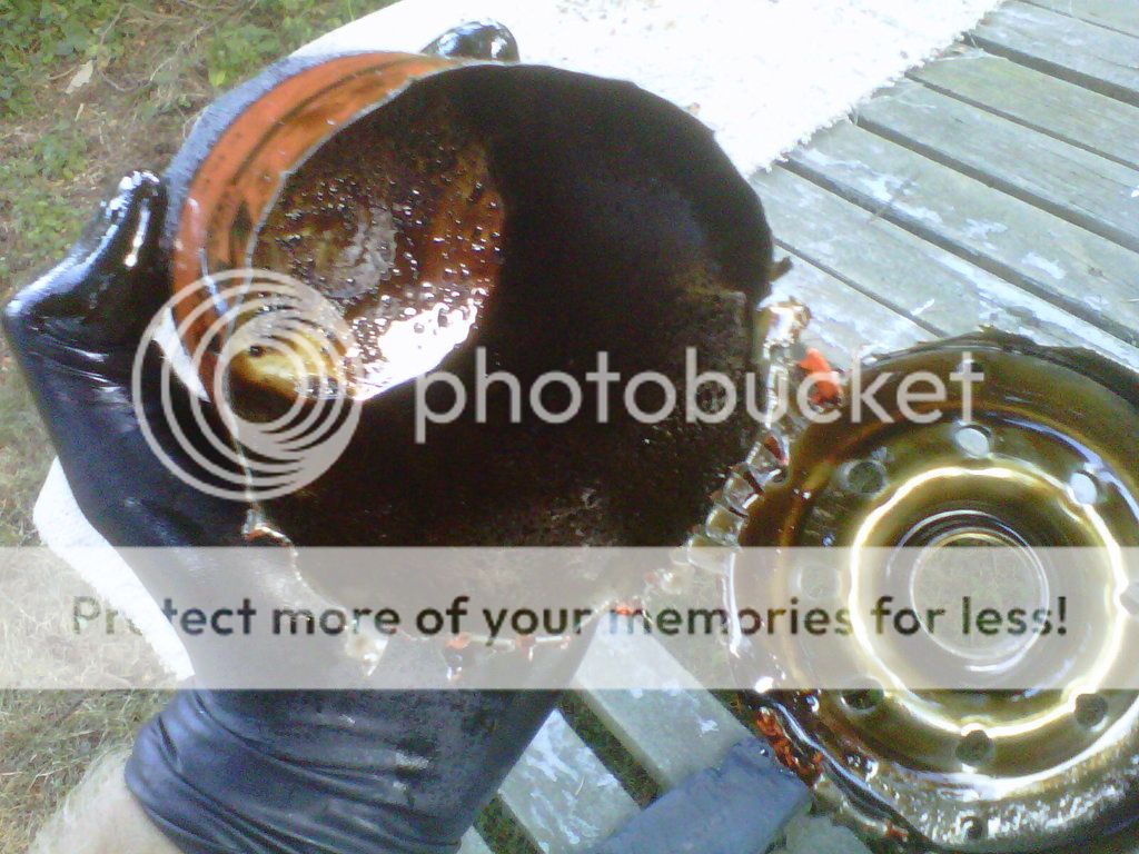

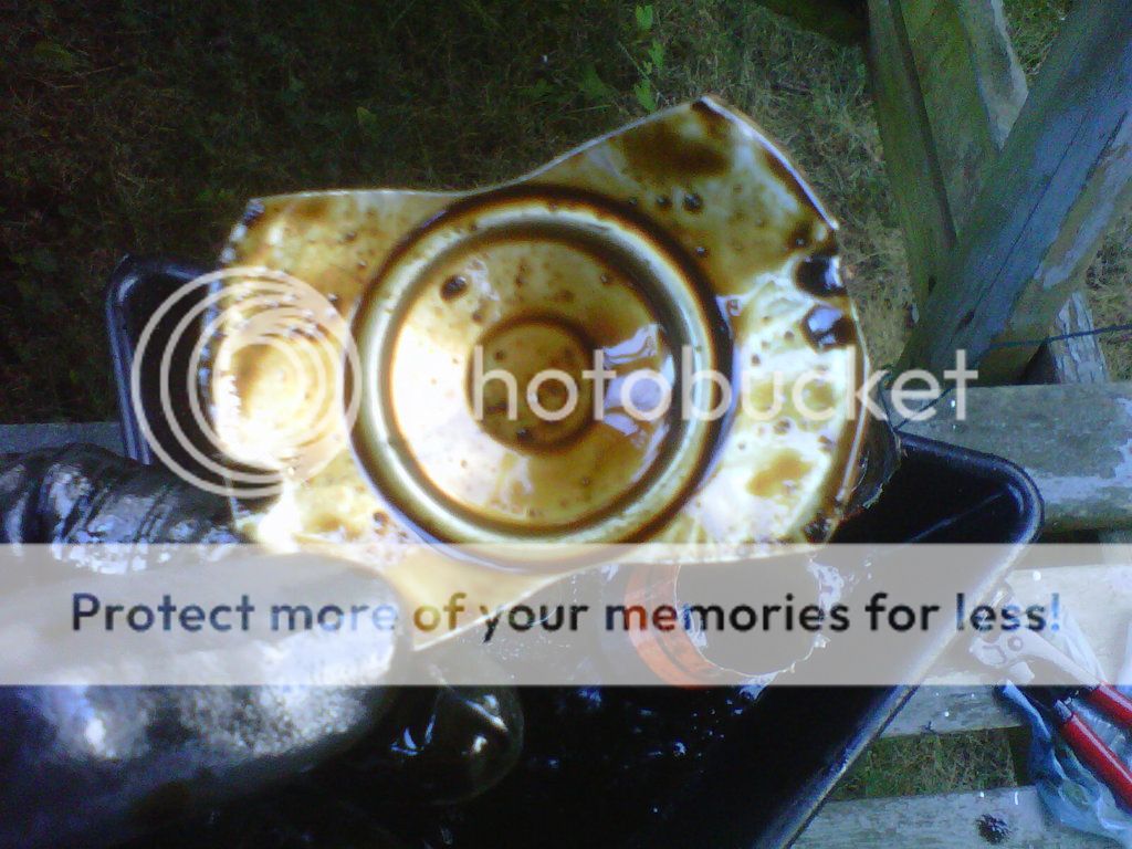

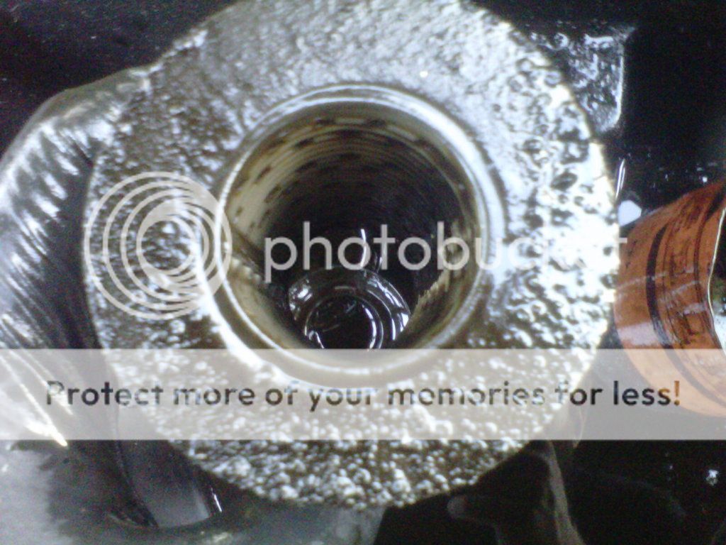

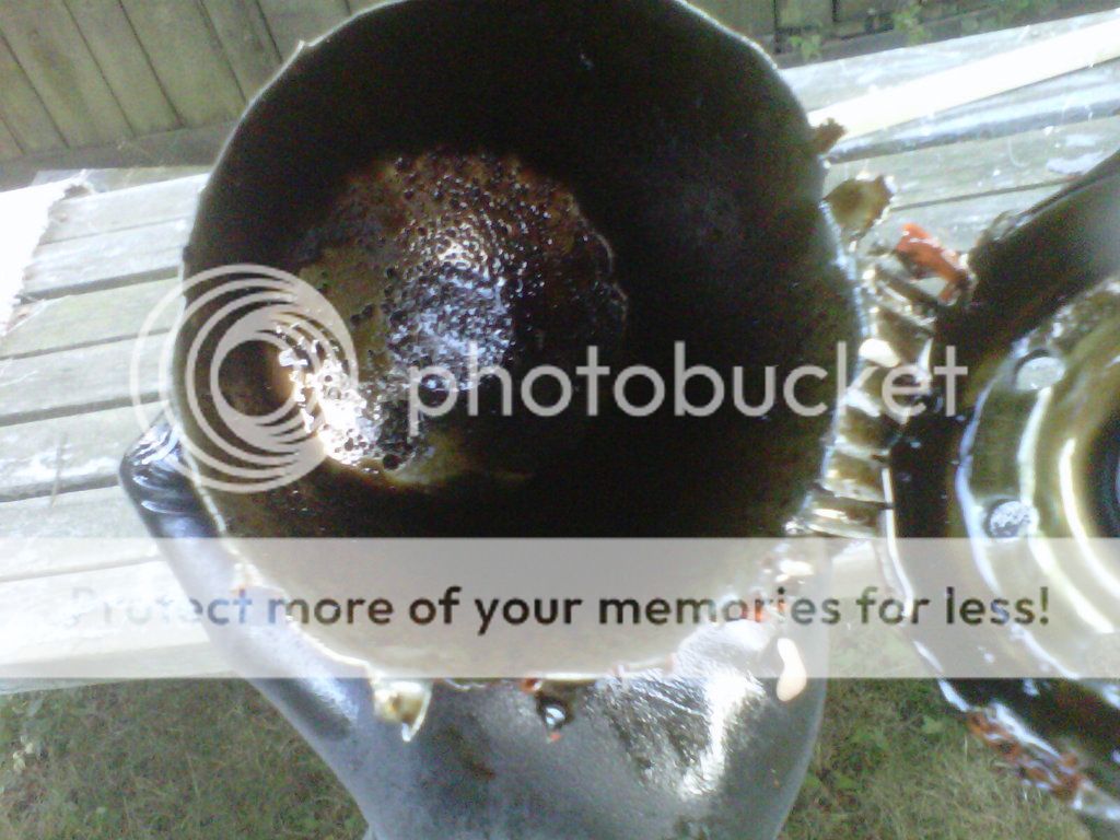

This came of a chevy truck. No idea as to the mileage on oil and filter. The oil looked well worn. Looking inside the can there may be serious air intake issue. Major crud deposits. All the bumpy stuff on the endcap is just crud. Chalk it up to another neglected engine. Date code A51703 The OCOD held up very well.
