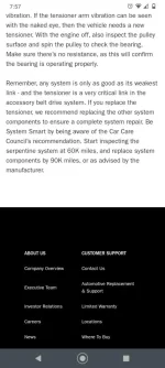

Recommendation is 90k
For a tensioner or a belt?
To me that’s more oriented towards the belt than the tensioner. Belts do elongate as well as wear (Gates used to send a measurement tool to those who ask for it).
My impression was that a tensioner is condemned when the Teflon washer is worn, or the index marks on a new belt isn’t in the right place.
If a new, proper length belt is installed and the tensioner isn’t in the right range of timing marks, I’d suspect that means either the spring is weak from use/time, or wear. I’d say that’s a good time to change it.
I’ve seen weakened tensioners get noisy and move in and out under operation. Then I’ve seen the OE tensioner on my 96 cummins that I could probably run another 100k…
View attachment 82890View attachment 82891
^ Yeah, saw that. But they want to sell the entire system... Of course. I get the belt being on that schedule. The tensioner isnt as cut and dry IMO...
Meanwhile I am replacinga 26yo, 265k mile orignal tensioner that could keep working if I left it....

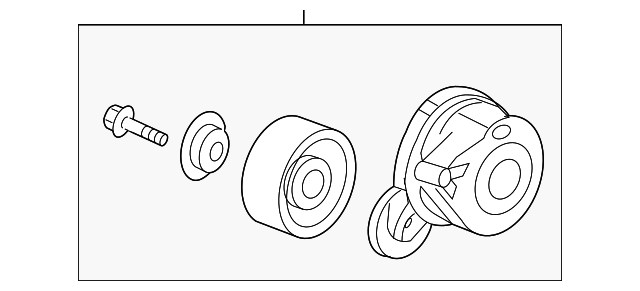

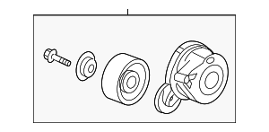

Here ya go, Bro​
Tensioner Assembly, Auto - Honda (31170-R40-A01)​
  • Tensioner Assembly, Auto - Honda (31170-R40-A01)
  • MSRP:$419.29
  • Discount:$137.53 (32.80% off)
  • Sale Price:$281.76
Sooo, you still didn’t give a car model or date? Is this from some exotic thing like an NSX, or from something pedestrian and accessible?
what are the design considerations that drive price? Known failure modes? Ease of checking it and replacing it?
All these things come into mind, not just the cost.
You are really funny! This is absolutelly the most inane post LOL.
Part Fitment​
Year Make ModelBody & Trim Emission & Transmission
2009 Honda Accord4 Door EX, 4 Door EX (PZEV), 4 Door EX-L, 4 Door EX-L (PZEV), 4 Door LX, 4 Door LX (PZEV)KA 5AT, KL 5AT
2008 Honda Accord4 Door EX, 4 Door EX (PZEV), 4 Door EX-L, 4 Door EX-L (PZEV), 4 Door LX, 4 Door LX (PZEV)KA 5AT, KL 5AT
