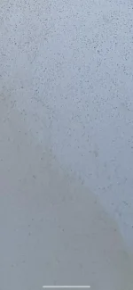

I’m painting my ecoonline. First thing is first-clean. Some spots have dirt so embedded, I can’t even get it out with a clay bar unless I spend 10-15 minutes on each 2’x1’ section (that’s a lot of time). Why?- because I have to go over with the clay bar at least 3 times before it somewhat smoothes out enough for me to be able to glide the clay bar. Then I have to press with all of my power on each square inch of this thing. It’s a lot of work.
*My question is, will wet sanding be a good alternative? It takes off the dirt beautifully and I’m sanding to paint it anyway (not going to bare metal) but, I’ve heard stories that when you sand before cleaning, the dirt gets imbedded into the paint and you can’t see it / clean it and it will cause fisheyes… I’m worried about that, so that’s why I’m using a clay bar to go around before sanding but I’m just looking for another way. I also don’t know what grit sand paper would cause the dirt imbedding that they were talking about (if I use 1200, dirt comes right off)…
