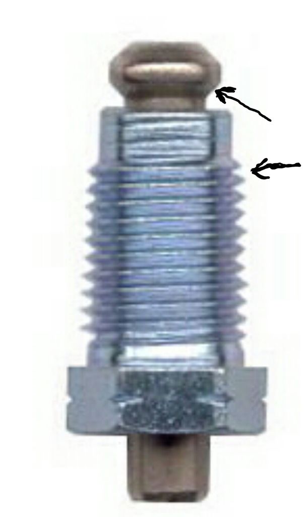

I looked up your rear brake hose- it doesn't thread in anything. Instead it slips through a hole in the mounting bracket and is secured by a retaining clip.
It should look like this:
RETAINING CLIP... thank you ok that makes more sense, its so rusty on that part I cant tell and didn't want to mangle something else not being sure whether I could get it also replaced. I just tried turning the apparent nut which wasn't really moving, didn't want to cut the hose not knowing it's replacement method either. So the retaining clip should slide out if moved in the right direction then I should be able to slip a new hose end through there, long as the upstream side also undoes fine? AKA if I mangle the end thats replaced by a new hose end/it's not a tee afterall just a mount hole.

Yes- just remove the hose- many times they're stuck... There will be a flat spot or tang to locate the hose in the correct orientation and also to keep it from turning while being tightened. You should also be able to find a replacement retaining clip if it gets mangled.
Don't worry about the long and short tubing nuts- unless you simply can't reassemble and tighten them down the way you bent them.
