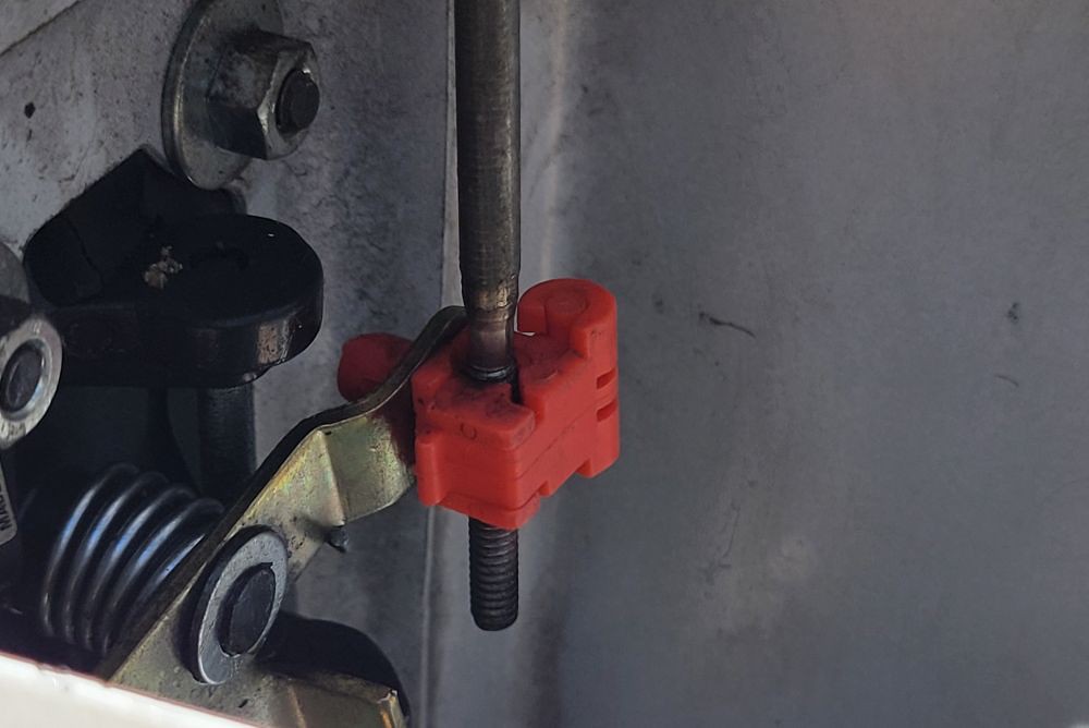

Side cargo door #2 has issues opening, the connecting rode is not pulling the latch open all the way, simply applying just a little pressure on the latch/rod allows the door to open.

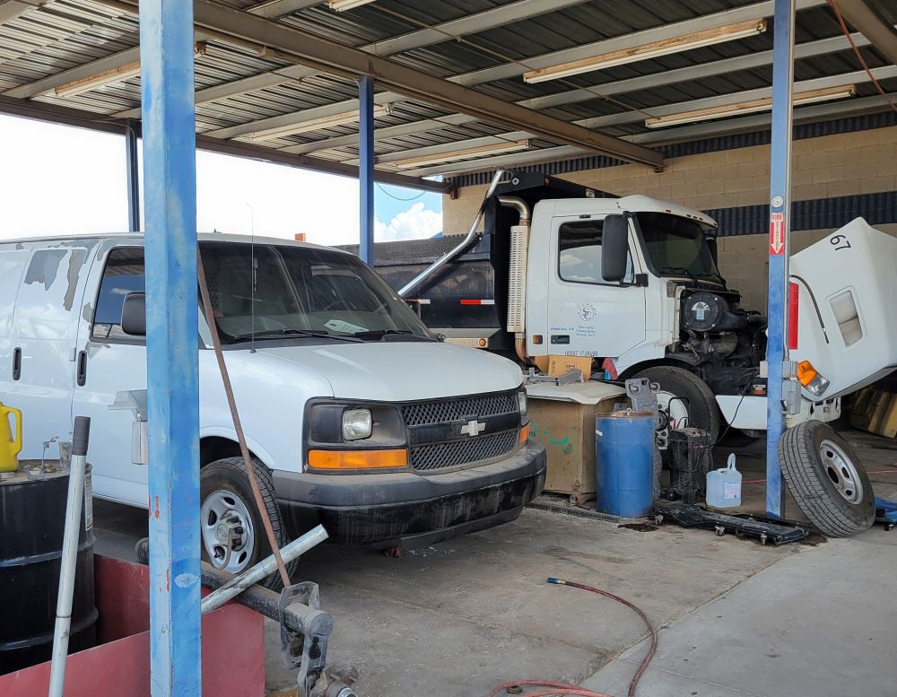

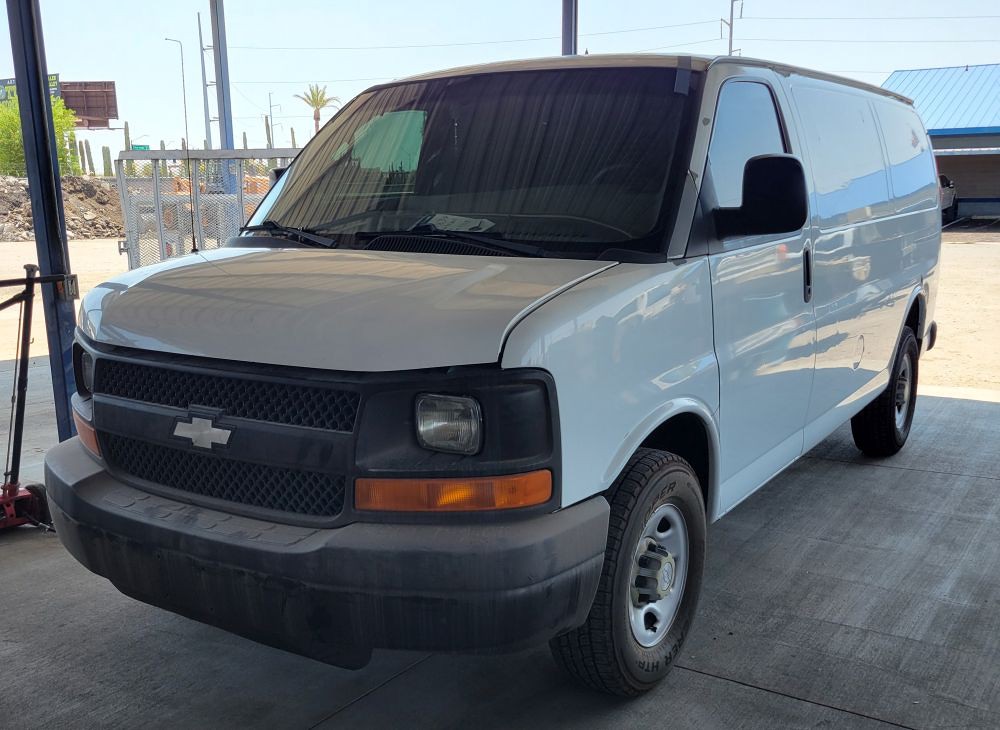

The first two photos are at my wife's work in their yard as I had their fleet mechanic do some service on it( oil change,trans fluid change, change the air filter) on it right after I bought it, he also checked it out before I bought it, you can see the passenger side paint peelling.

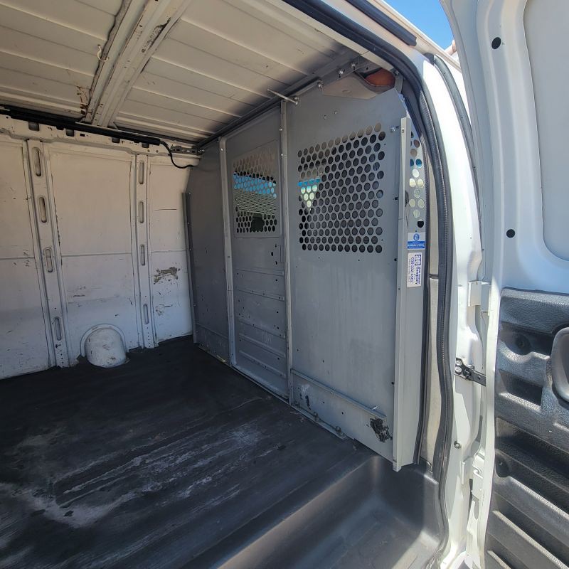

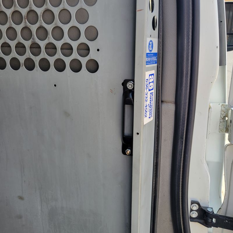

Random pic of the cargo partition, one reason I bought this van, it had it, its also heavy, I leanned that the hard way when I took it out in order to take out the cargo mat so I could clean it.

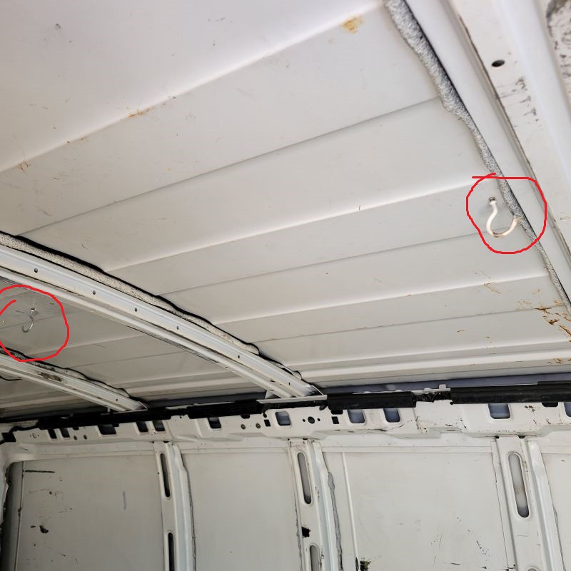

Here you can see the hooks that are screwed thru the roof

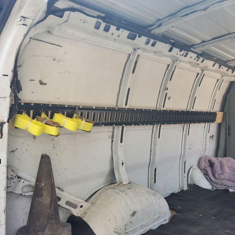

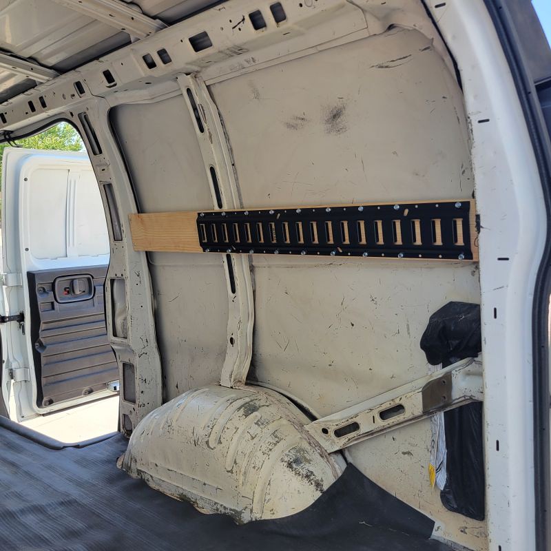

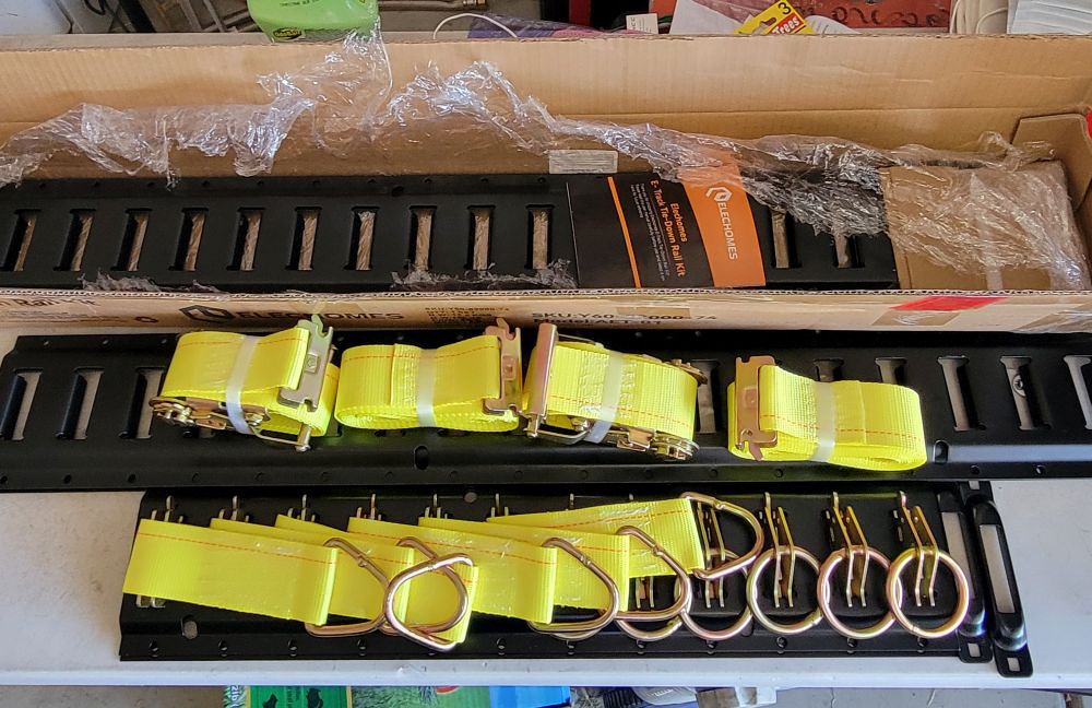

Making some progress , the E-Track set I ordered , it came with 4ft x 2, 3ft x 2, 2ft x 2, two straps/ratchets , O-rings hooks and strap hooks , which those will come handy as I can use my other ratchet straps for the time being. My current plan is to do 8ft on the drivers side, 4 feet on the passenger side, and then a lower on the driver side, probably 5ft at a later date after I know for sure how I am going to load it.
I got the 8ft and 3 ft done, I am going to add a 1 footer on both sides as soon as my local HF gets them back in stock.
The set also came with two single pieces, had no idea at first what I was going to do with them, then I thought about I could attach them to the cargo partition( one on the left side but no pic)
I also finally fixed the issue that was not allowing the side door to open on its own, all I had to do was open the clasp and slightly pull the connecting rod down and re-secure the clasp. It took longer to get the door panel off.
