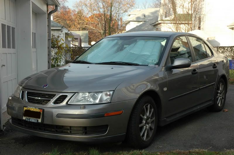

Mine needs a wash... got to keep up with those excellent but dusty brake pads!

Nice car JHZR2. All it needs is a wash and a wax but looks like keeping those wheels clean is a like a full time job. After 500 or so miles my wheels are coated with so much dust and they are not silver any more but more like a gun metal color. I guess I don't have to invest in after market wheels. My 5 spoke wheels should be much easier to clean though. I love Steel Grey but because of end of the year dwindling inventory I had to settle for Silver on my 2006.
