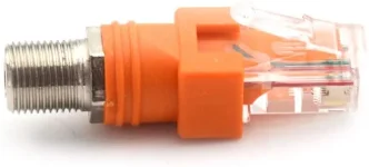

The new box does have a hardwired ethernet port I'm guessing cat5 on the back of the box. If coax can support 4K can I just do a coax to ethernet converter plug like this?

You may not use a coax to ethernet adapter as it will not carry on the ethernet data.
If your room does not have ethernet, you may rig up that wall coax output to use MoCA .

IP on coax (MoCA) was always a stopgap thing that cable companies used since many homes have existing coax between rooms, but not Ethernet. The technology involves active modems at each end of the coax, not passive plug adapters.
