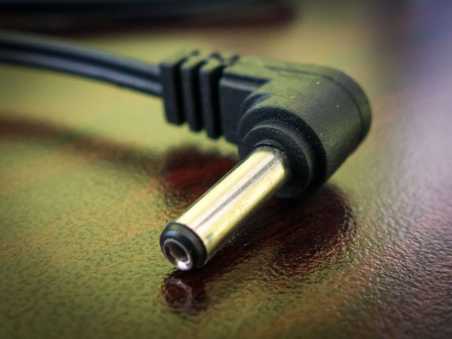

I've got this ac/dc adapter/charger that expects a 240V input. My options are:
1. Find a similar ac/dc adapter that accepts 120V input. But how would I search for something like this online? I can find various 3.6V adapters on Amazon, but I don't know if the round plug would be the correct size/diameter. This adapter is used to charge a built-in (not easily removable) battery inside a toy. I'm not sure if the charging logic is built into this adapter or if it's inside the toy itself. Since it is 3.6V, I'm thinking this might be a Li-Ion battery (or maybe 3x1.2V NiMh batteries?) which requires special care when charging.
2. Buy a voltage transformer (from 120V to 240V) and just use this existing AC-DC adapter as is. This way, if the charging logic is built into this adapter, it would be preserved.
Thoughts?

Yes, I can buy a suitable voltage converter for about $16 from Amazon. A new ac-dc adapter would probably cost about the same, maybe a few bucks cheaper, but I don't even know how to find one with the exact same round plug. That's why I'm thinking I might just buy the voltage converter instead.

If the label on that wall wart is telling the truth, the voltage is too low for Li-ion as those need to top off around 4.1 or 4.2V (unless there is a Boost in the toy, which is unlikely). I suspect it's for a different battery chemistry.
What's the toy? Maybe the instruction manual will give some insight into the battery chemistry. A lot of packaging nowadays requires lithium-ion battery labels.
If it's at all accessible, you could open the toy to check out the internals. Once you know how it's wired and the chemistry, you might be able to hack off the adapter's plug and use any other off the shelf battery charger you have.

It's a remote controlled car. Text on the box says "Use 4.8V rechargeable battery (include)." It's a cheap Chinese toy with a ton of grammatical errors all over the packaging, so none of it can be trusted.
I decided to just buy a voltage transformer and use the supplied ac-dc adapter.
When plugged into the voltage transformer, the actual DC output voltage from this ac-dc adapter shows 6.2V on a multi-meter. That's double than what shows on the label.
I have never seen a wall wart whose voltage unloaded, hooked only to a digital multimeter, matched the specs listed on the wall wart itself.
Unloaded DC voltage is always higher than spec, sometimes significantly so.
