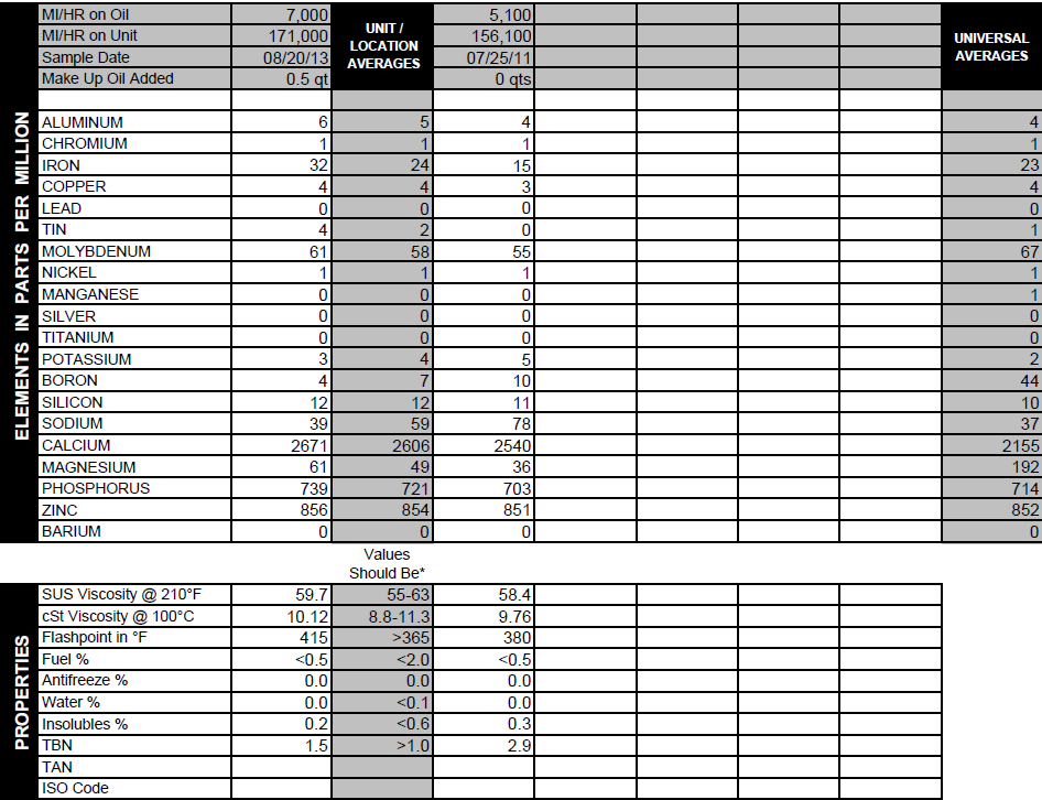

KCJeep> curious why you think 4.7's are not good with longer OCI? Actually any background on this engine is appreciated, I've had mine (2001 Dakota w/ 172k) for 13 years and it has been the most reliable vehicle I've ever owned. Engine doesn't seem hard on oil, but I've been pretty good about changing it before 4k. Switched to longer OCI about 3 years ago, or 24k, which amounted to basically changing the oil once a year. Up until then I used Mobil 1, after finding BITOG decided to try something else. Now use PP. I could probably go with a dino, but I like the cold start flow of a syn for a truck that is never garaged. Here is the UOA I did before starting longer OCI, last one thickened up some, but otherwise good.

His is a totally different animal than yours. You're fine, you've had it forever, taken good care of it and used Full Synthetic to boot. That's exactly why yours is doing so well and will likely continue to do so.
His is a completely unknown quantity being "new to him" at 14 years old, totally different scenario. The 4.7 will sludge if neglected and he really has no idea what the insides of his look like, its history, nothing. Not a good set up to start doing extended OCI's on a known sludger (if neglected). JMO.

Well here's an example on your own used oil analysis. On the 5000 mile run you've got 15ppm iron yet the 7000 mile run iron more than doubled to 32ppm.
In 2000 miles iron more than doubled.
Not that I put much if any real stock into the metal seen in a cheap used oil analysis but if a person was to consider them at least close then the iron doubling in such a short time after the 5000 mile threshold it could make an argument for shorter intervals.
At 5000 mile intervals I wouldn't use a synthetic though,unless of course it was bought on sale cheaper than conventional,then of course I'd run it but if I was buying oil when I was ready to change it and no sale was going on I'd use conventional.
And to be honest conventional seems to show better wear metal numbers on a 5000 mile interval. Where synthetic shines is at longer intervals the wear metals will trend down for longer which ends up potentially shedding less wear metals over the entire life of an engine.
Just my personal observations.
