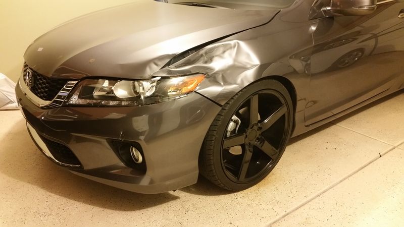

Ironically my car was backed into by a coworker of mine and we both work in a body shop repairing wrecked cars for a living and have State Farm insurance. I left work and realized I had forgotten my phone so I went back and parked in the side lot to run in for a min. On the way out I was talking to the painter for a minuet and we hear a loud crunch! It took like 30 seconds to process what had really just happened. The guy that hit my car was freaking out and I just said "dude, it's okay, I am not even mad about it." Really, what is getting mad over an accident going to do? It's not going to get my car fixed so it is what it is. It's fixed now and everything is fine. Enjoy!

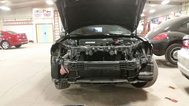

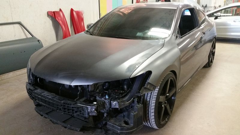

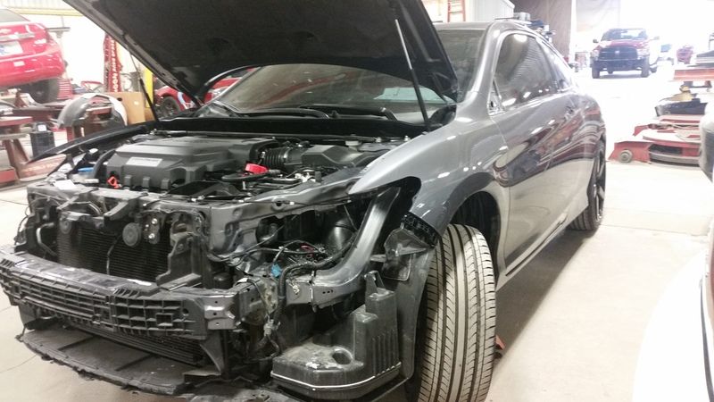

Today I was pretty freaking busy getting my car tore down, sent the new hood and fender to paint shop to be jammed out as well as 4 other cars I have going. Thank God nothing was really damaged under the fender and headlight area, just bent the fender mount bracket and some scratches in that area.

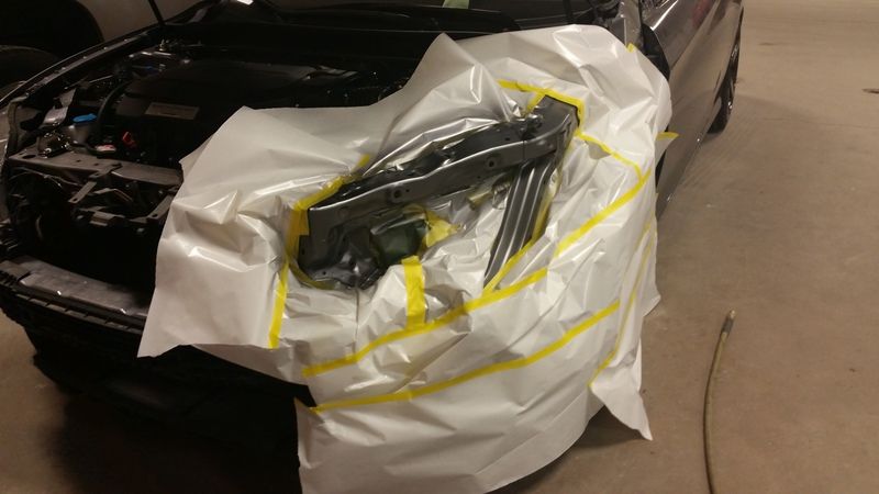

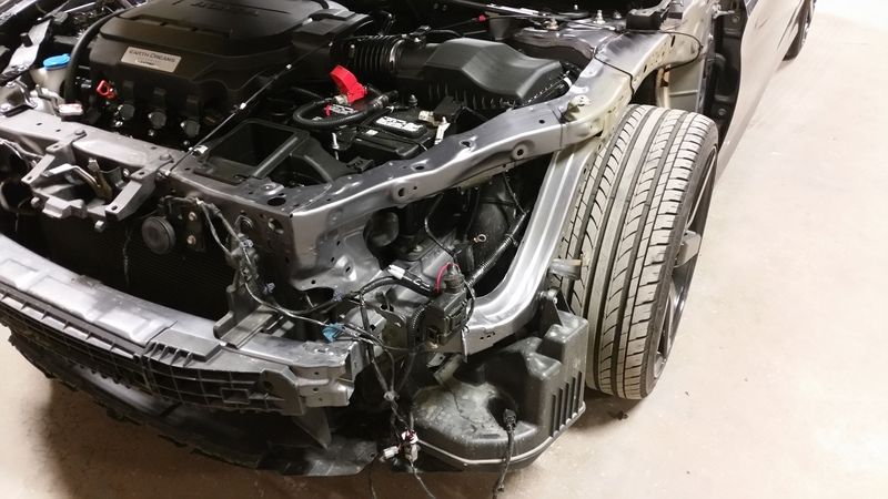

This here is just the left front upper rail and radiator support, like I said nothing major. Wiring is pulled back so the painter can paint that whole area when parts are getting jammed out tomorrow.

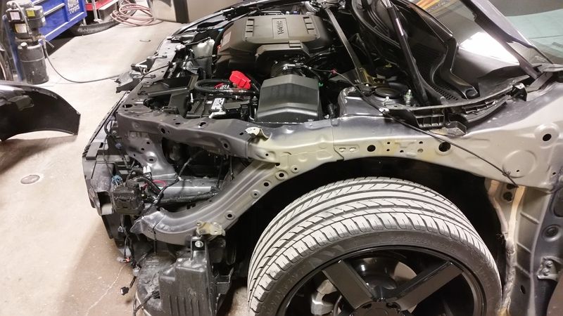

Just another view.... same thing. I love Honda's ACE body structure that is designed to take an impact higher up on in the body just as well as down low in the "frame rail" of the unibody.

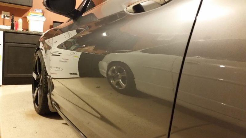

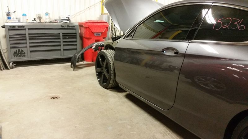

Door has trim panel, handle, mirror, belt molding removed for paint.
Left front radiator support and upper rail was painted along with the under side of the hood and fender. Hood and fender are bolted back on the car and should be sprayed tomorrow.

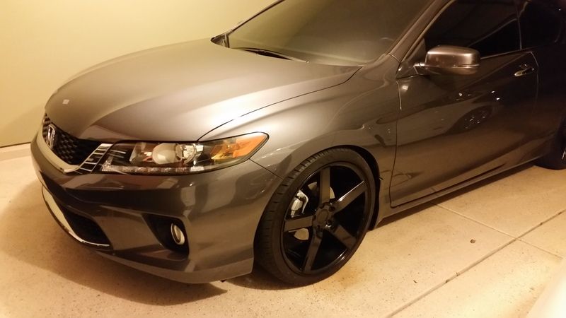

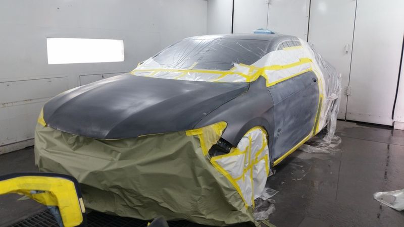

Here we are with the panels on, everything has been sealed and some base coat applied. The hood didn't fit worth a [censored] so I had to do some tweaking but everything looks cool now.

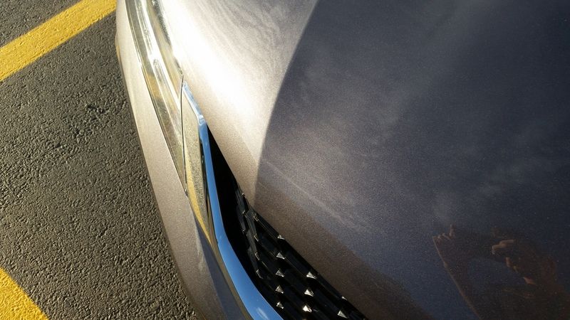

I was hoping to put the car together today but I had some setbacks with other jobs in the shop and my own car. Oh well, that's what Monday is for. The right fender did not get paint blended into that it because State Farm has some stupid rule that you can not do that right off the bat. They want you to panel paint hoods to fenders and see how it look and blend it needed. Although the color is very close, I mean so close that 99% of people would not notice, but it's not good enough for me. So the right fender was blended off today. Also I bought the Honda mud guard and had them painted body color as seen in the previous pic sitting on the horse.

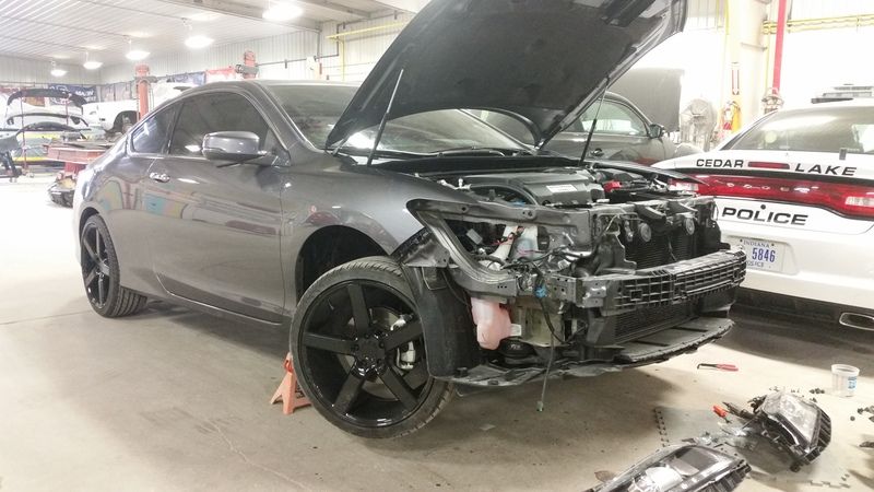

Well I put her back together today and it looks like a car again and I forgot to take fully assembled pics but I have these in progress ones. I had to work in the isle because my stalls are filled with other jobs right now.

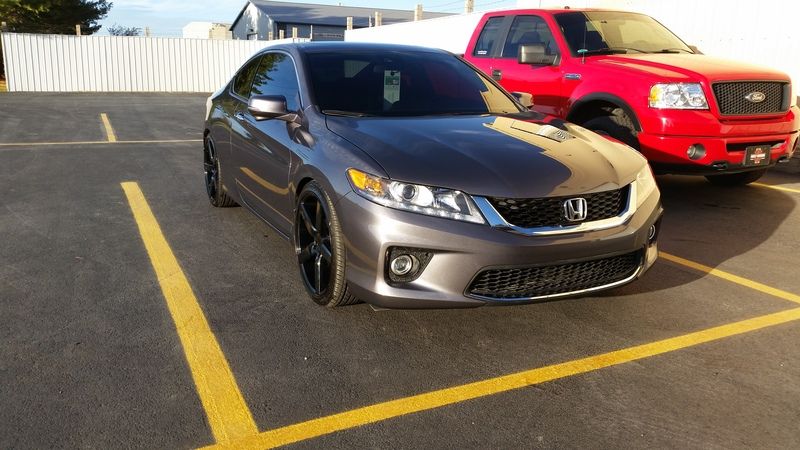

All done! Almost smoked 3 deer standing in the middle of the road less then a mile from my house, that would have sucked. I was driving through the wooded area and I know deer hang out in that area, I could not see them because I was going up a hill and as soon as I got to the top, bam oh hi deer.

Looks like a Chief frame rack?
I'm not sure what the big orange rack is behind my car in the one pic. It is used for trucks and other heavy duty full framed vehicles. That thing is probably older then me and I have used it once or twice.
The other red racks are KJ racks and the shop has 6 of those. I like them a lot.
