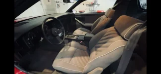

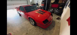

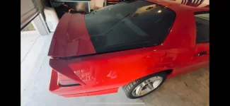

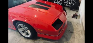

Excuse the mess. I just put 17" wheels on it and a double din radio in it with Focal K2 components. The shifter knob was still off and center console not together when these were taken.
