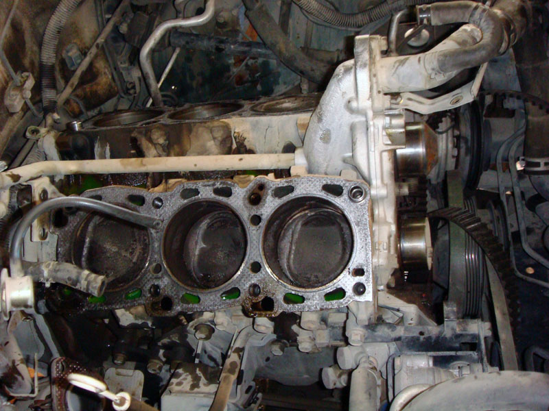

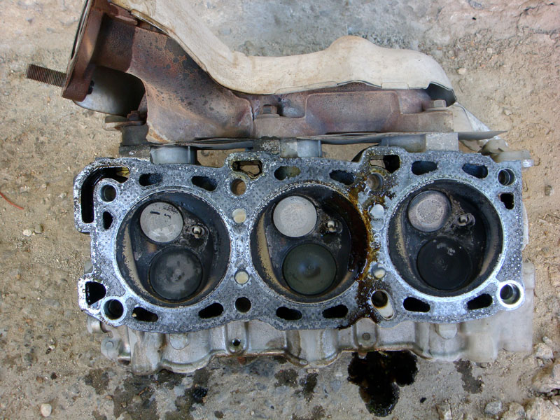

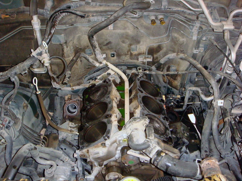

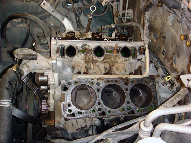

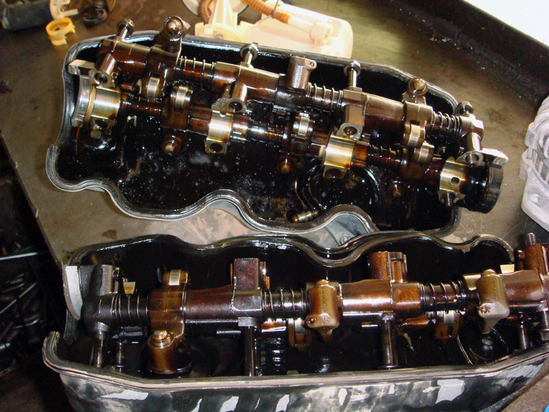

Some pictures I took of the cylinder head I started overhaul today. Took about 4.5 hours to remove the cylinder heads, and even more effort to remove the really hardened valve seals. They were literally rock hard, despite 4 ARX treatments. I haven't done anything to the pictures other than shrink them, I'm about to hit the sack.
Anyhow the heads are now at the shop, they've put them in a tank for cleaning and they will be installing the new valves and valve guides tomorrow morning. I've also got an overhaul kit, so I'm replacing everything right down the the exhaust manifolds and head gasket whilst the head is off. Going to be running Motorcraft 10w30 for a while with some MMO prior to the OCI, and make the switch to Mobil 1 0W-40. That should clean up all the dust, sprays, etc. used during the process. Thanks to StevieC for the suggestion!
No more smoke, no more oil consumption.
Good news is, the spark plugs and injectors were quite clean - thanks to MMO and TC-W3.
Here are some pictures I thought I'd share:
While I'm sure that this engine was available in something like a Montero, this is the first time I've seen it in a North:South installation. I've only ever seen it transversely mounted.
Mike, the varnish actually surprised me a bit as well, but I'm hoping Mobil 1 will be able to clean that up.
Gary, this engine was available on 1991-1996 Monteros in the North American market. It's so much easier to work on when it's longitudinally mounted!
That is some nasty, nasty varnish on that head!
It's going to take WAY more thn M1 to clean it up - why not clean it while you have it off?
The heads are actually in a cleaning tank right now.

I understand this is pretty much a splash area, and the real work is in the ring packs. But that's really what I was hoping for, so it was quite a shock to see the state of my heads when the covers were pulled off.

I haven't seen a Mitsi engine that dirty for awhile...we need to go back to the '80's to see that much gunge.Mind you,we don't pull them apart that much - valve guide seals means the car is off to the wrecking yard.But pulling rocker covers off gives us a good idea of what they are like - did a rocker cover gasket on a '94 L200 petrol today,just shiny alloy inside.
Maybe using 15w40 is the way to go?
The reason the Mitsu engines & Chrysler 3.0L's which are virtually the same, had that level of "gunge" is because they weren't using EGR valves and were running extremely high cylinder temperatures causing extreme cylinder head temperatures and oil coking.
I'm not sure if Falcon_LS's engine has an EGR valve but he certainly has the climate which will produce high heated cylinder heads and cause oil coking with mineral oil.
In 93/94 Mitsu & ChryCo they came out with the EGR equipped 3.0L and this problem was drastically reduced and also the oil consumption problem due to hardened valve seals also reduced because they weren't being baked hard in the engines due to the lower cylinder head temperatures.
