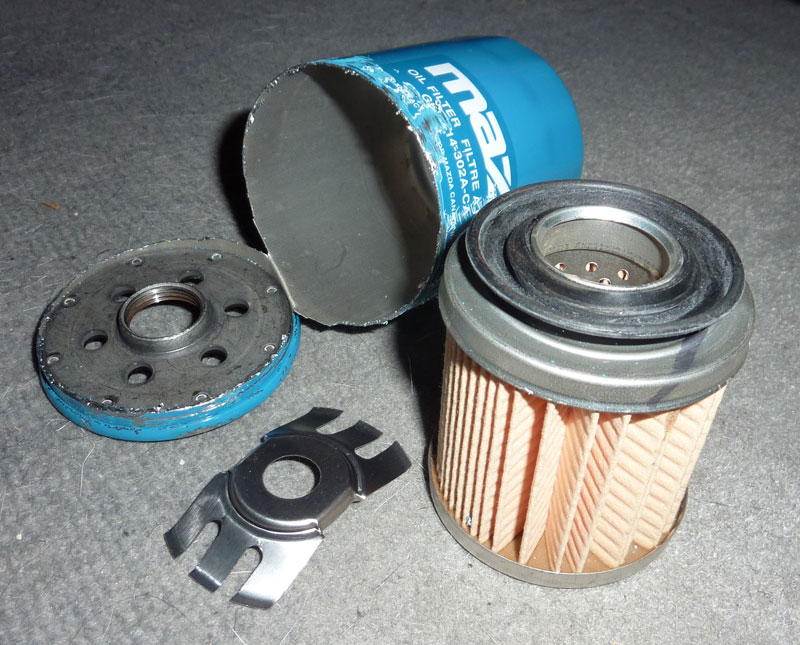

thanks focus for posting that canadian "G6Y0-14-302A-CA" filter... as I stated in my original post, this is a tennex filter... don't let the blue color deceive you, it isn't made by Honeywell as some others have stated on other forums (this maybe true in the past, but there's no way to confirm this)
I've tried to find pics of the B6Y2-14-302A (Tennex filter) but I only came up with dead links... so anyone who wants to really see for themselves, have fun searching!
