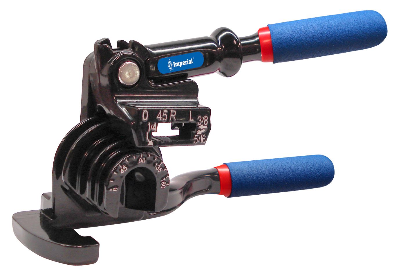

I have some nice bending tools but with NiCopp you can put them away, even with a bender you still need a bending spring to make the tight loop found in some ABS units and a piece of 2" plastic pipe for the coil at the master cylinder.
This stuff is so easy to free hand it makes the job of bending child's play.
