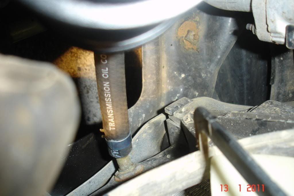

I found the cooler return line by feeling for the hot and cold line after a long drive. I double checked the flow direction by undoign the hose and pointing it to a 1 L beaker. As I was alone at the time i had to start the car, run around to the front, check flow, then run back - in 6 seconds, about 2/3 of a quart came out - that's a lot of flow.
I had to cut the old hoses free from the barbs. the old hose clamps were also dug into the old hose by about 1mm, they seemed a better fit and a bit wider than the current new clamps.

Connection at cooler at the radiator
