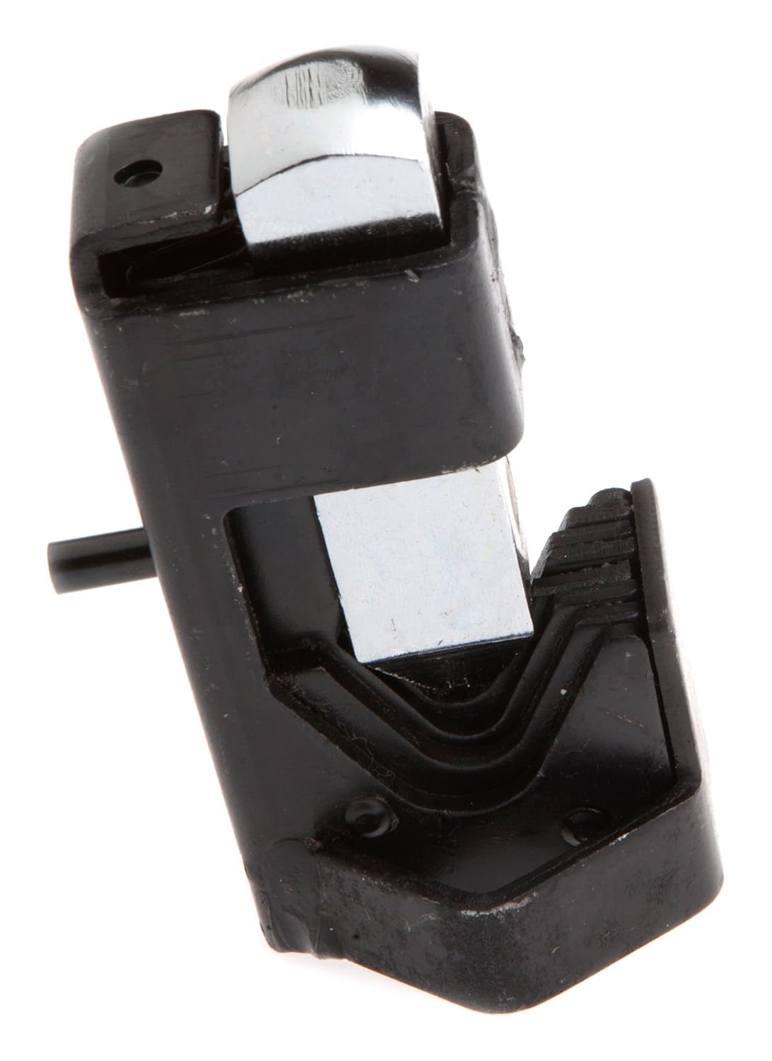

Do you prefer the hydraulic crimpers or would a hammer crimper like pictured below work. Some people say they use a big punch and a piece of angle iron to make crimps also.

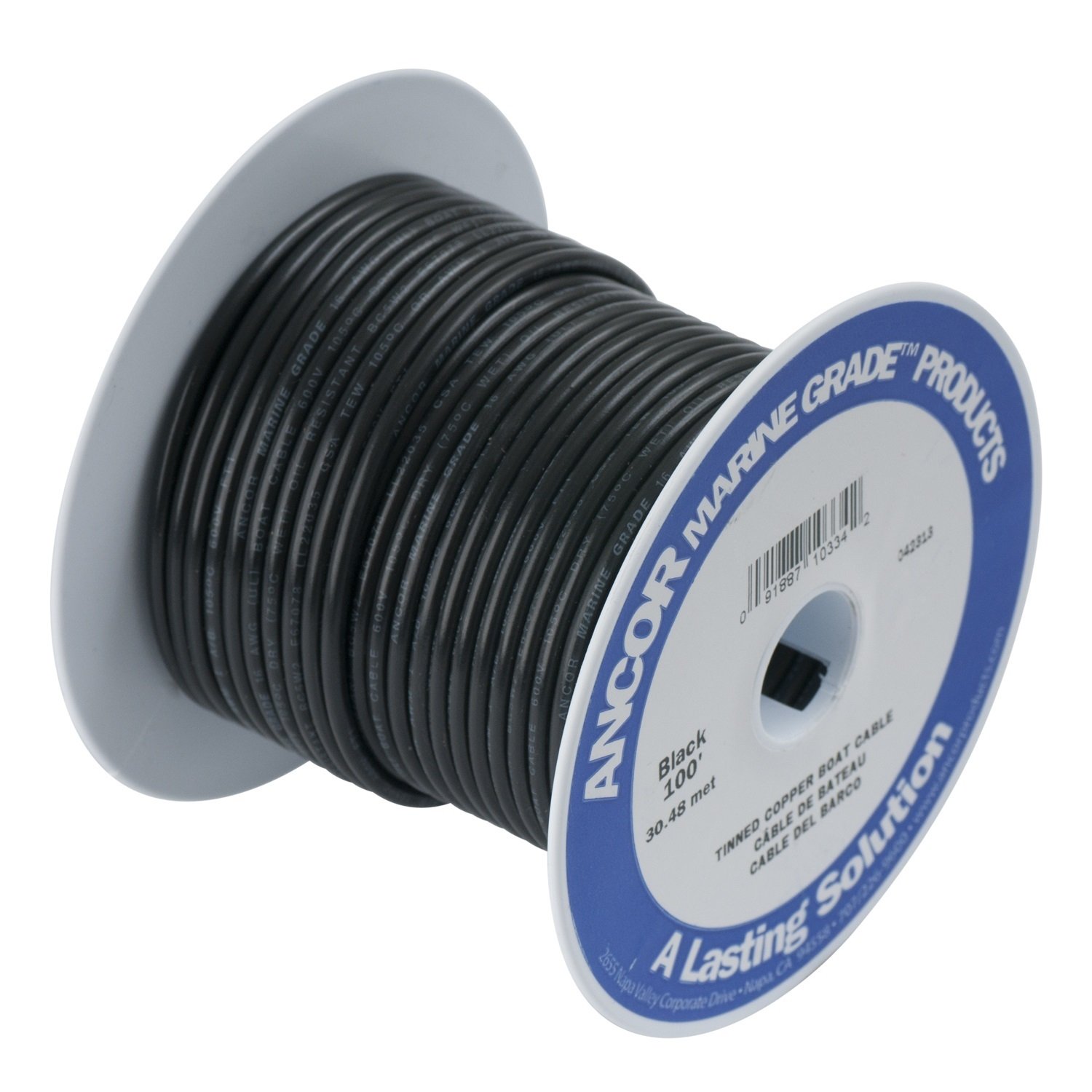

I was actually considering Ancor brand tinned copper wire and tined copper terminals. Seems like some of the best based on reviews.
