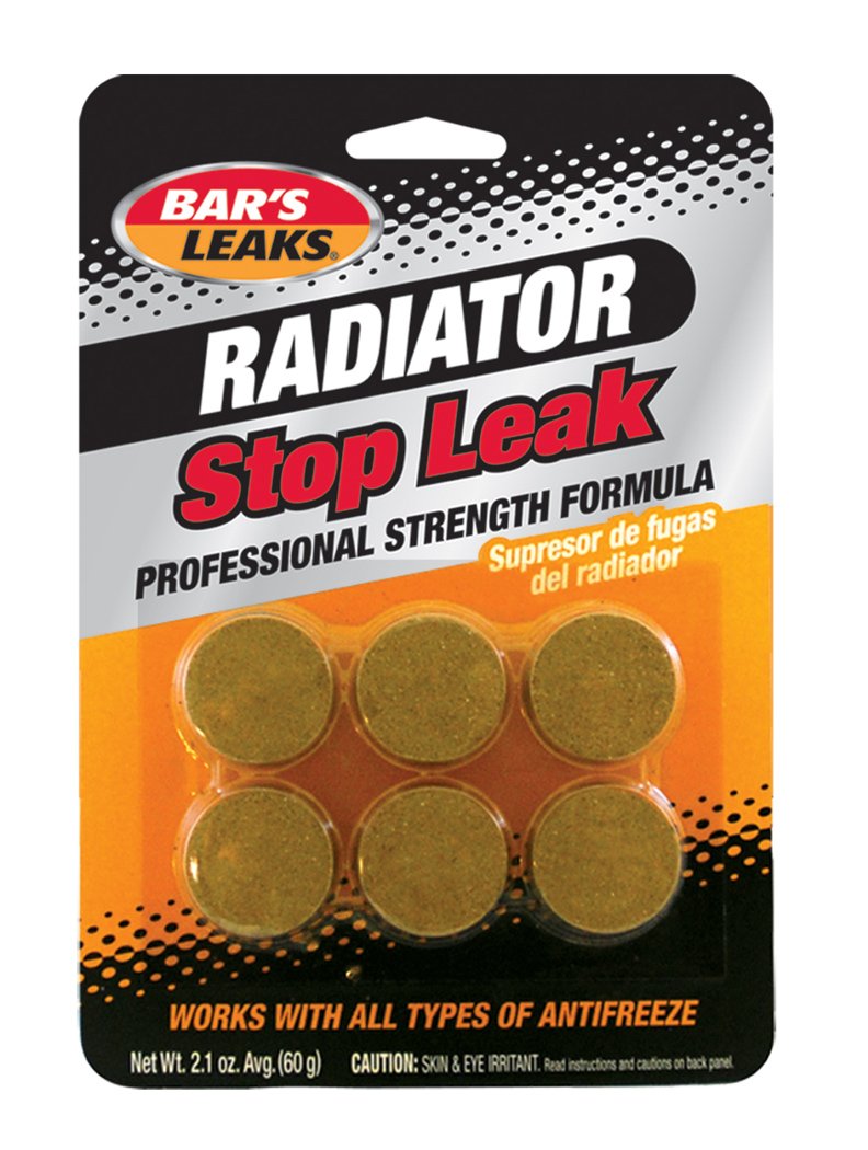

Go to your local GM dealer and get some cooling System seal tabs, or Barsleak tabs, they are both the same.
These are the thing i would recommend as they will not clog the system. They are made with ginger root which when soaked expands only when exposed air. If these don't do it nothing will.
I've had good luck with this product. It sealed an old, leaking, rusty '74 Suburban radiator for 5 years. Cheap at Napa.
+1 I used these on a minor leak in my Equinox and it sealed it up perfectly.
Sealed more than one radiator with the Bar's tablets especially on those pesky weeping plastic side tanks.
I managed the leaky heater on my son's beater when he was in school. I used the Bars Leak that had pellets in some sort of goop. I dosed it with a 1/2 bottle every 6 months or so. Earlier tries in other heaps had negative results using the aluminum powder.
