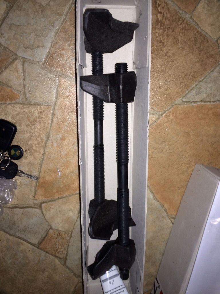

Klann is the correct spring compressor for MB applications. Those are the top quality and safest compressors to use. I didn't buy one of those, because as much as I love my diesels, I don't think Ill ever get enough use. Struts are another story, so I bought the Klann KL-0005 to do my strut job on my Saab. What a nice tool! Very smooth operation, nice metal.
Came right from the vendor:
European paper box:
Here they are:

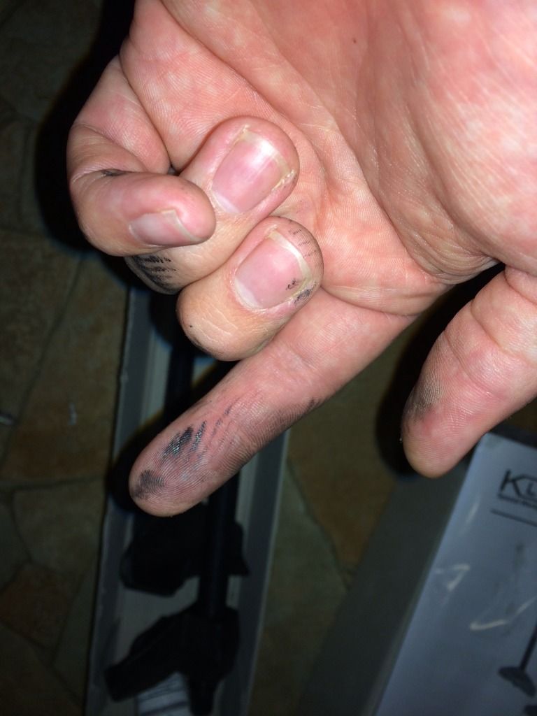

Handling them made a big mess on the hands:

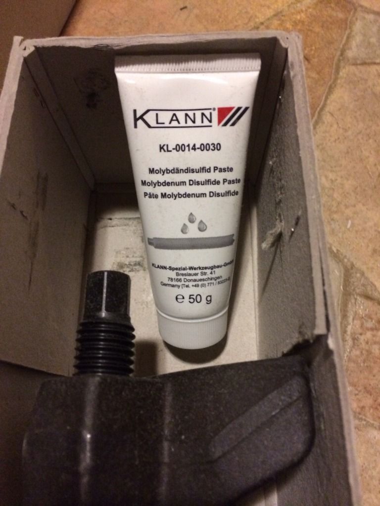

Apparently they are coated in MoS2.

If you don't mind me asking, all the Klann spring compressors I have seen covers at least half the circumference of a coil. is yours a new design?
You're right. For example the Mercedes units for 26000N springs have that. These are a more universal design for struts. Klann makes a lot of variants, and the ones that you speak of cost into the thousands of dollars... And are overkill for struts.
As for coverage, the jaws are good for about 1/4 of the spring I'd say. So with two you've covered about half the spring. The other units with much more coverage generally use only one compression screw, not two opposing ones like this.
