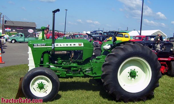

FYI, when I started my current career some 35 years ago, we had one of these and it earned "my all time favorite".....I miss her:
Always wanted a 550! Great tractors. We have an 88 and a 70, my grandpa bought both of then new back in the day.
