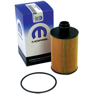

But I'm sure they will also try to tell me I need to use the oil filter from the Mopar box. $40-50 instead of one that is most likely the exact same quality or literally from the same batch and just marked up less and sold by a different supplier.
I was on rock auto just now:
$3.55 for a cheapie
$15.27 for the comfort a WIX branded item would give me
$36.79 for the Mopar......
Now I'm just [censored] and moaning, but it seemed relevant.
I'd use the OEM filter. $40 is outrageous for a cellulose cartridge filter but every 10k isn't a big deal.

I came up with the $40-50 figure using a part number for a ram ecodiesel as I was having trouble finding the oil filter listed for a 2020 Wrangler Diesel. Found it 68498720AA $60-70.......WOW.......
I stumbled across it because a website specifically stated the old part number would not work on the ecodiesel Wrangler. Would you pay $60 plus shipping for a nothing special filter every 10k miles? If this oil even lasts that long.

I'd pay the price for the OEM filter while under Powertrain warranty. I use the Delvac with OEM filter.
I was considering buying one of the 1500 ecodiesels in 2017 because they were heavily discounted. But I read about all the engine failures with the 3.0 and decided against it and got a Canyon CCLB 2.8 Duramax 4x4. It was more expensive than a similarly equipped 1500 Ecodiesel but it has been trouble free for me. OEM oil filters are $12 too.
Considering the sordid past of the 3.0 ED I'd be doing as much as possible to be compliant with the warranty and document everything to CYA.
