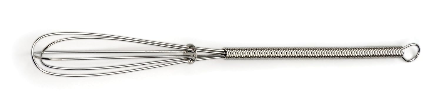

Then again, you don't need to buy a special viscosity. You can end up with whatever you want by mixing motor oil with grease, thoroughly. I use a small stainless kitchen wisk in a power drill to mix it just thin enough that it will squirt out of my oil can.
